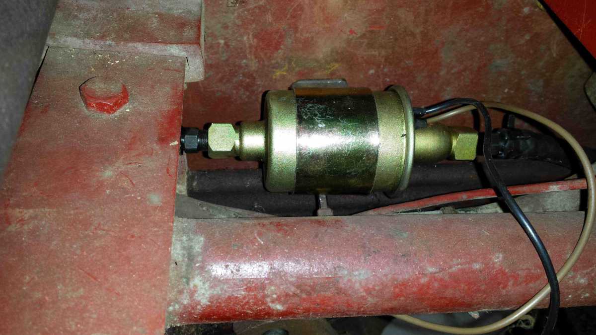

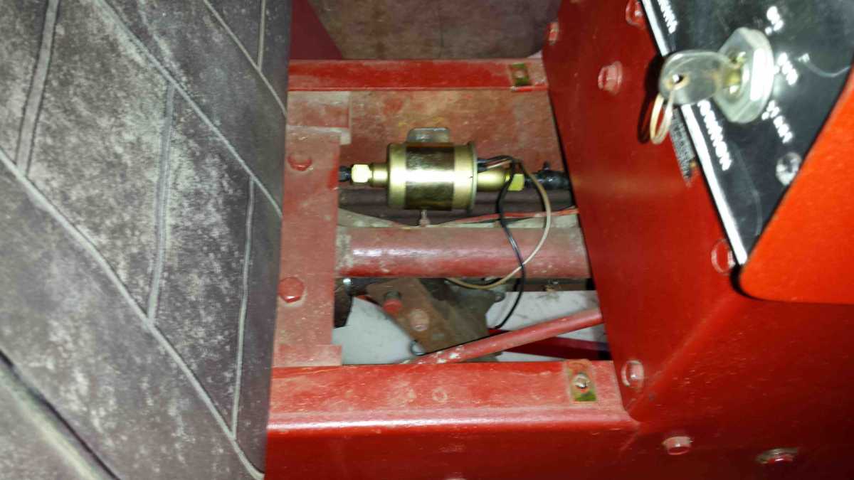

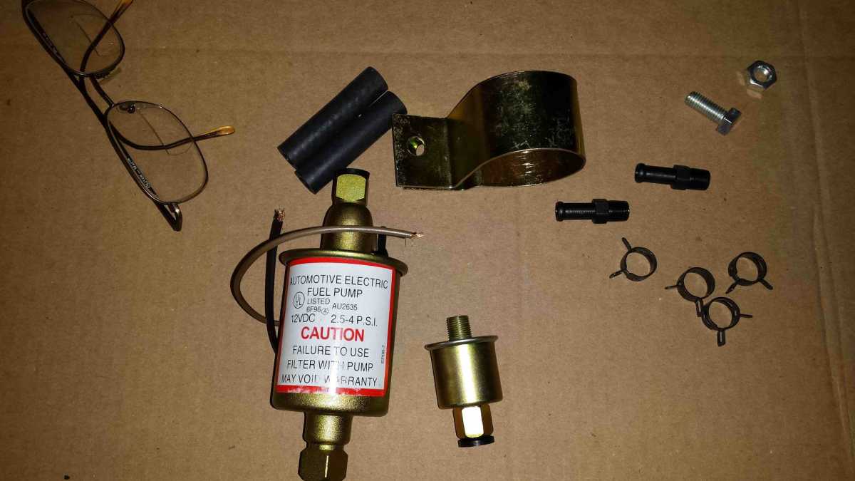

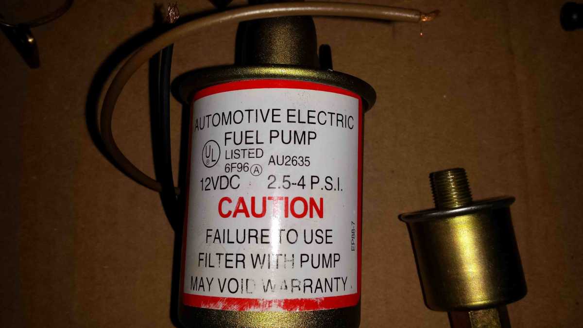

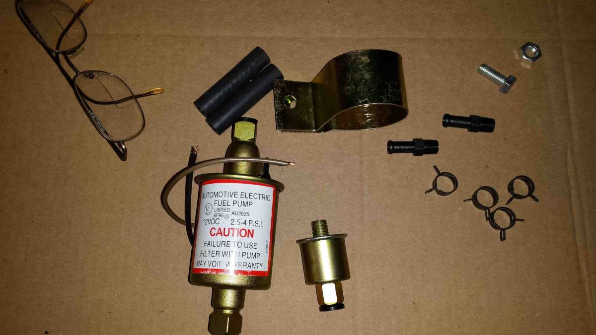

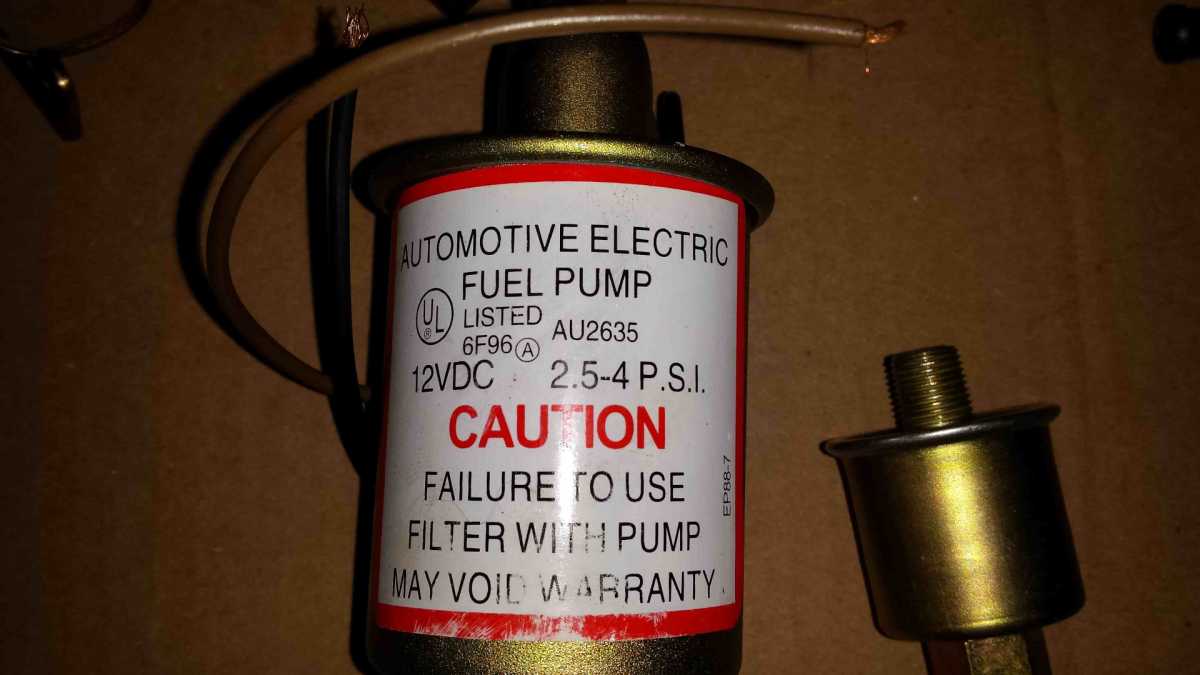

The D series has a vacuum pump that sometimes takes a while to get fuel to the engine after the tractor sits a while.. Always wanted to try an electric one....got one for a little over 15 bucks off ebay. They are bigger than I thought....kinda hard to find a good spot for them. Still have to wire it and add a new filter after the tank/before the pump. I did install a filter before the carb....a small one.

Replied by Geno on topic Electric Fuel Pump
Really nice job Bob, looks like the prefect spot too.
Does that tractor have an oil pressure switch or a place to put one?

It does not have an oil pressure gauge. However one could be added....
