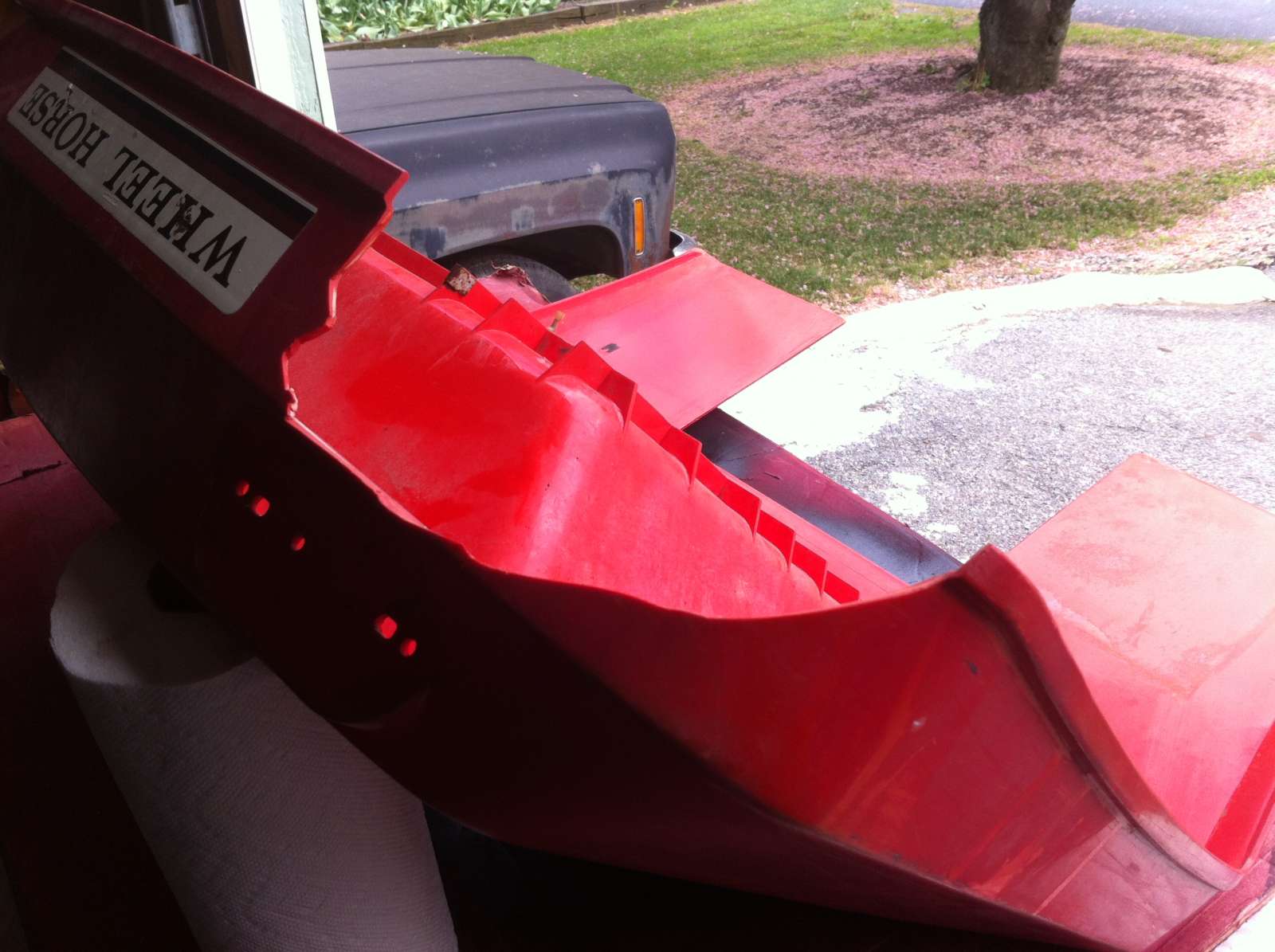

Plastic fender repair
13 May 2015 19:50 #4469
Plastic fender repair was created by GT 14
- Posts: 2013
13 May 2015 20:52 #4473
Replied by nappypappy on topic Plastic fender repair
yup its broke....will be watching the repair... :smile2
- JustinW.73
- Small Engine Mechanic
- Posts: 348
13 May 2015 21:17 #4474
by JustinW.73
Replied by JustinW.73 on topic Plastic fender repair
Fiberglass tape and putty here we come!!!

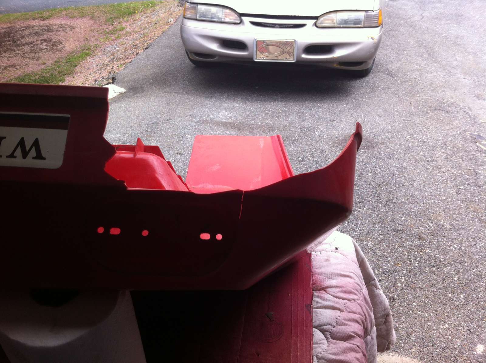

I have a sheet of 1/8 ABS and I am fabricating a patch. I think my trusty JB Weld will handle the job.

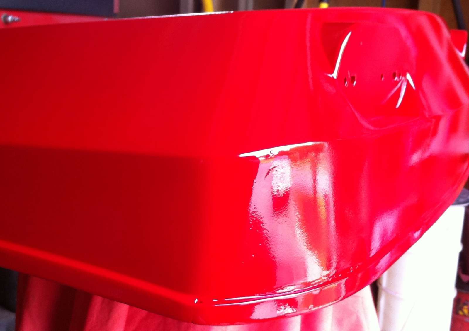

Replied by GT 14 on topic Plastic fender repair

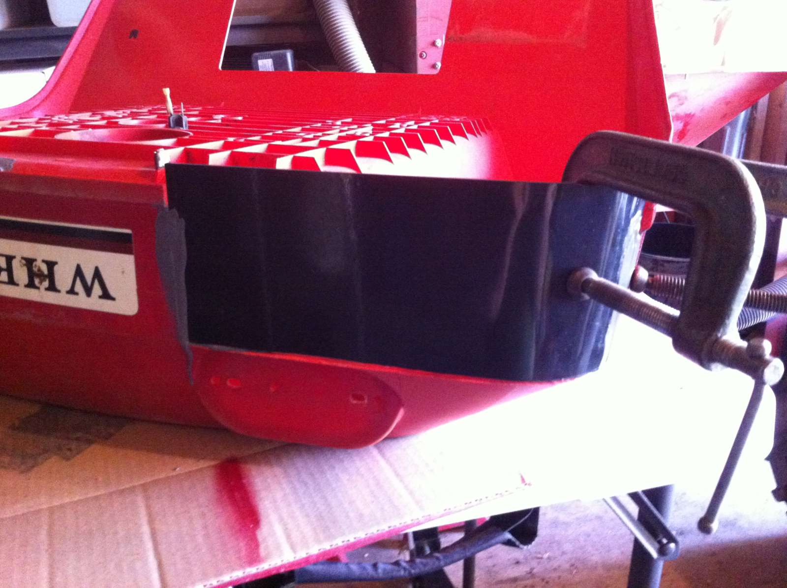

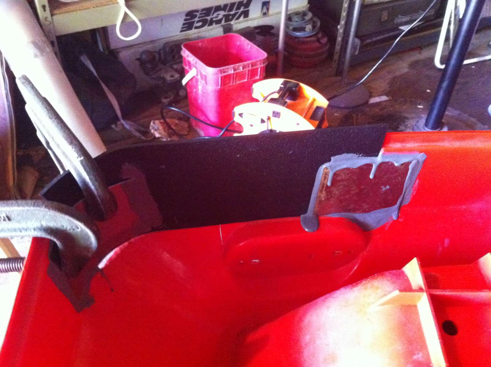

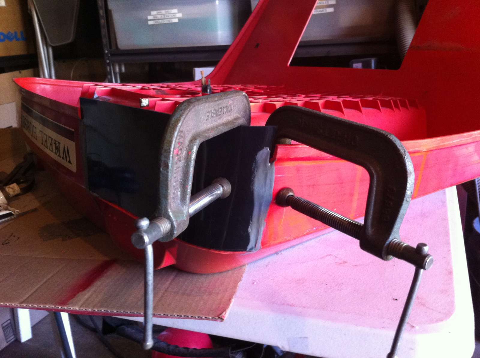

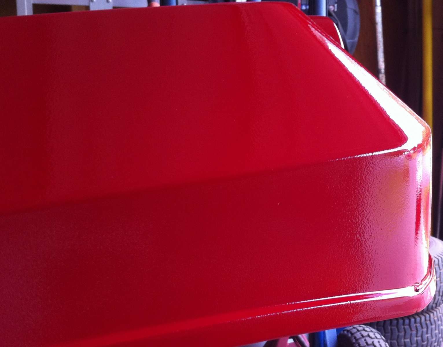

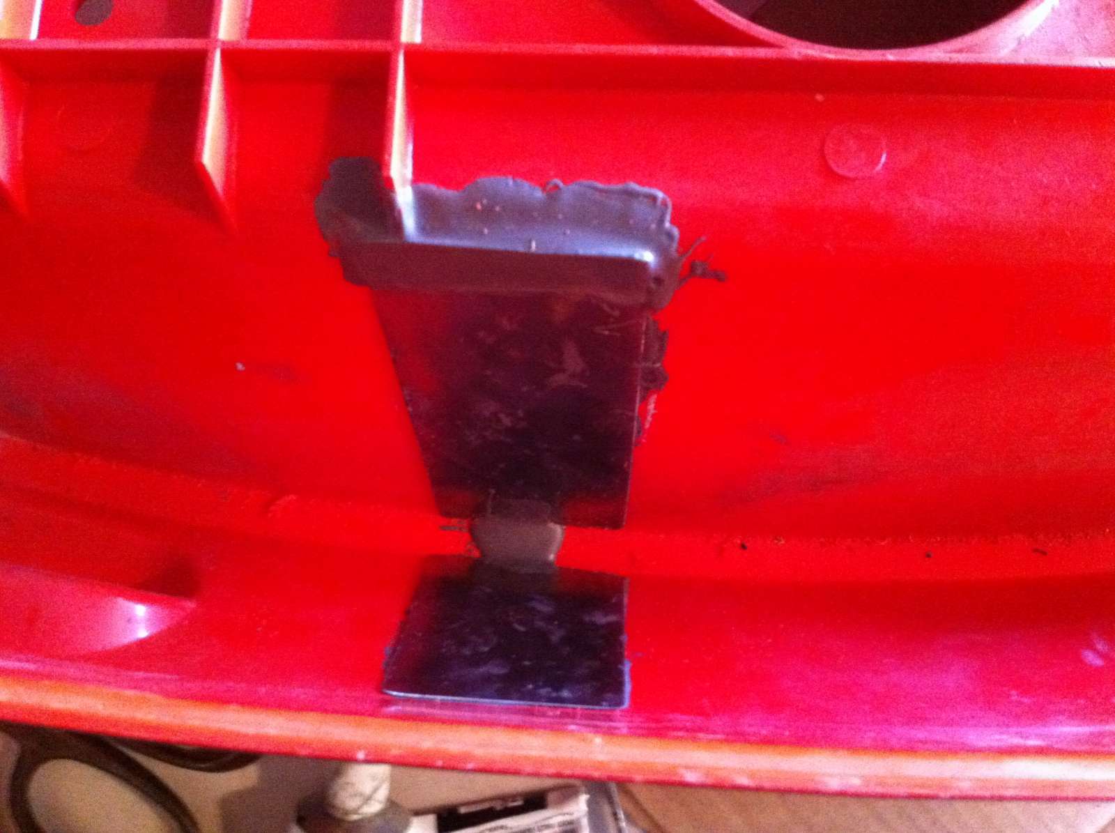

Here we go
Squared up the area, and cut and shaped 1/8" ABS. Used heat gun to get the curve.
Decided that strength was needed so I am using small squares of sheet metal.
Covered the entire piece of metal with JB and clamped.
Also repaired a large crack down the middle with same process.
Finally the new fender has emerged!
:cool looking good.
