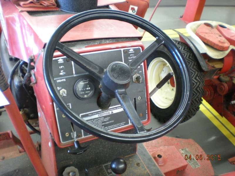

08 Apr 2015 15:39 #2861 by Geno
Replied by Geno on topic Roll pin size
Nappy's came off in less than 1 minute in the press. Makes it easier to do the wiring and get it where it belongs with all of the panels out of the way. Your wheel looks great Nappy, just needs a cleaning and center cap.
The C175 is a solid wheel Bob. This is the one I knocked the pin out of a little to get a measurement for GT. :)

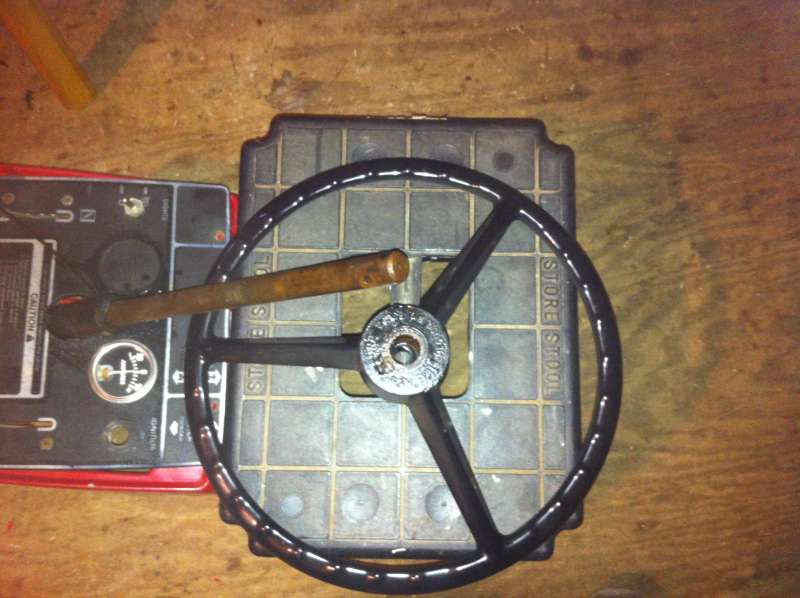

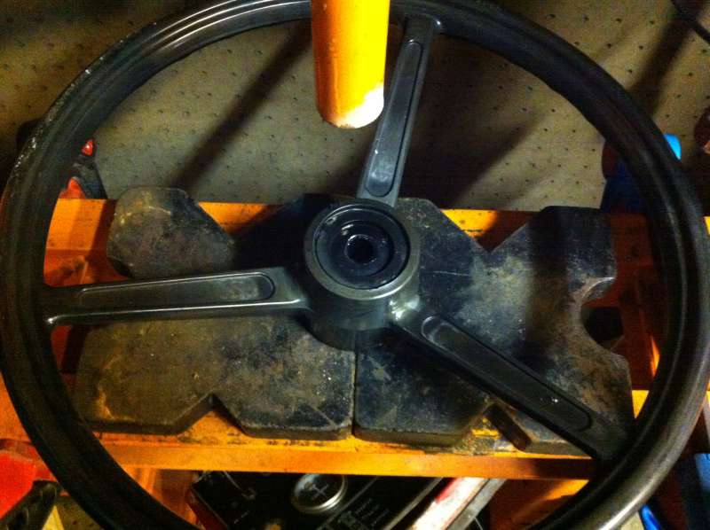

09 Apr 2015 08:48 #2903 by GT 14
Replied by GT 14 on topic Roll pin size
Drilled 1/2" hole and ready for pressing!
Free at last Free at last
The reason for all the work! Now for some prep and paint!

09 Apr 2015 08:57 #2906 by Geno
Very nice. How bad was it? Always wondered if they would be easier because they couldn't get water in the top. :confused1
09 Apr 2015 09:01 #2907 by GT 14
Geno wrote: Very nice. How bad was it? Always wondered if they would be easier because they couldn't get water in the top. :confused1
It took everything the press had and resisted all the way, and that's after a two day soak.
09 Apr 2015 09:02 #2908 by M Bailey
Replied by M Bailey on topic Roll pin size
GT you wrestled the bear and won. Thank goodness for the shop press.
