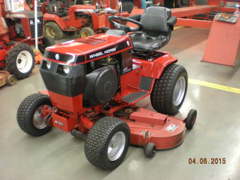

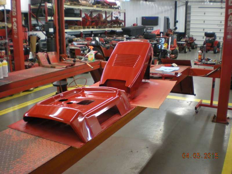

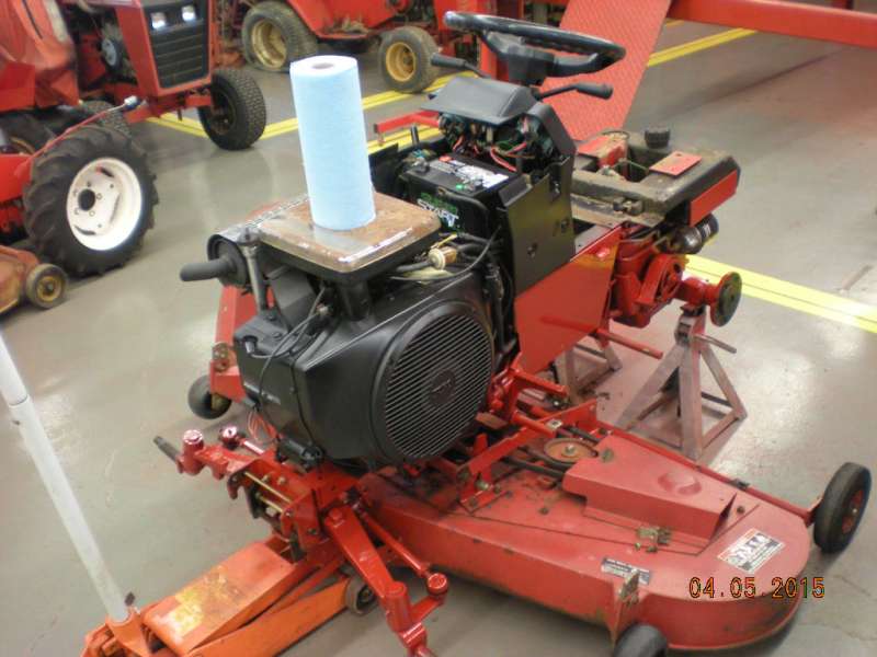

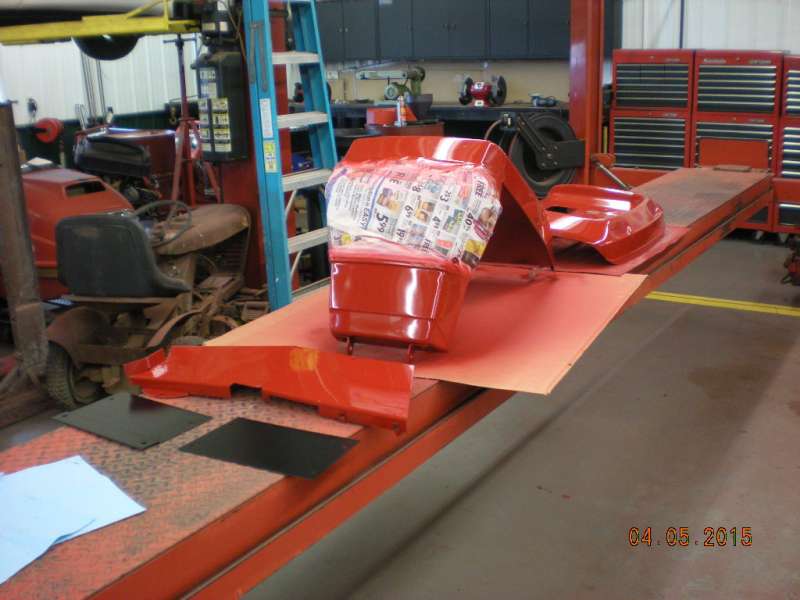

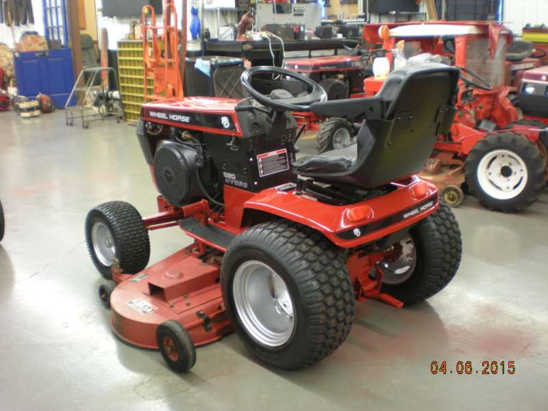

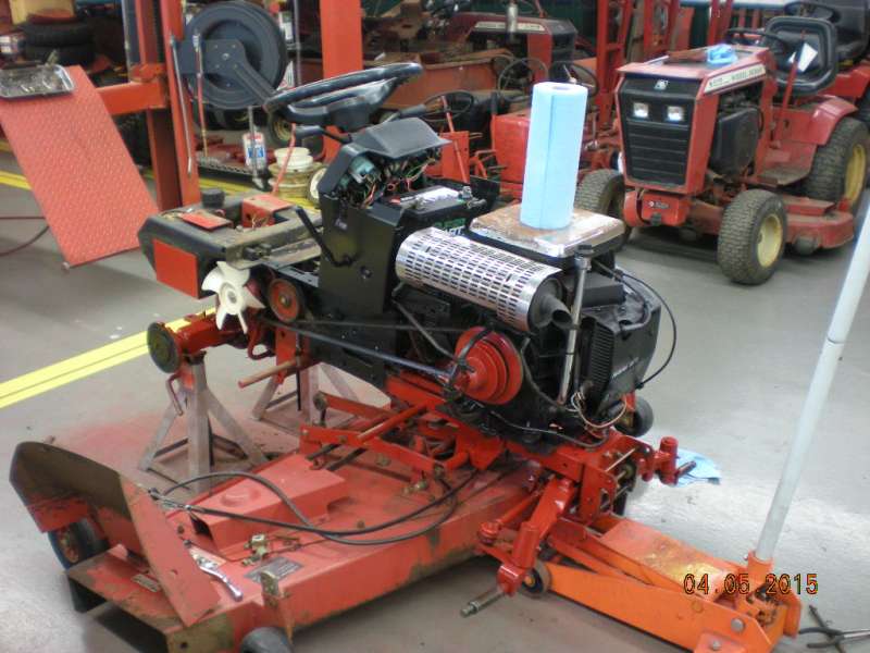

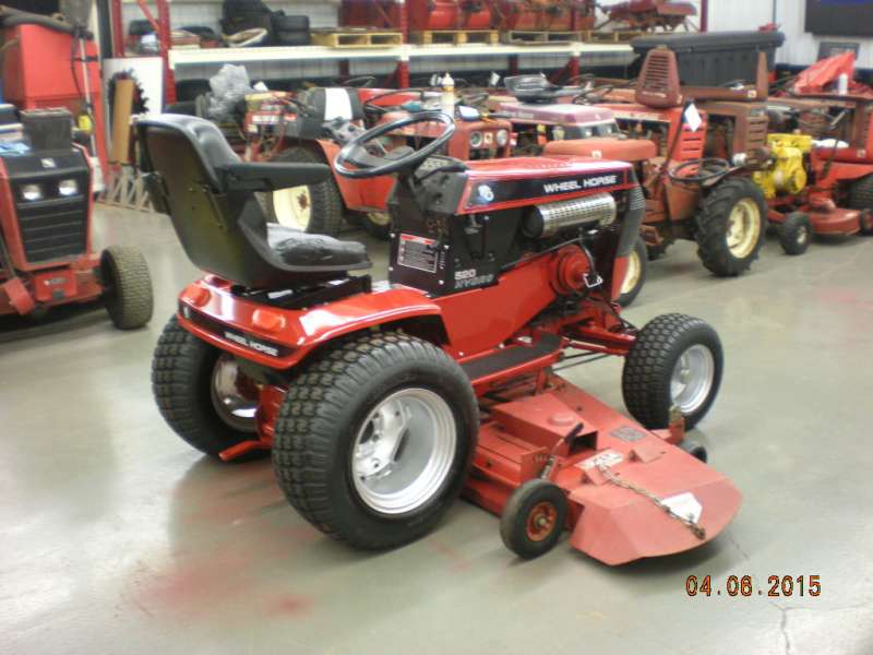

We've started on getting ready for the mowing season and this first one to go is gonna be the one that takes up the most room, we really need some space.
We started on it last Saturday morning and by that evening it was all striped and painted. We spent yesterday putting it back together, fixing some wiring, and finishing it up. Sandra will get some pics of it finished after breakfast. :smile2
The tractor was very solid, but the paint was really faded.

Looking great.......you using rattle cans or air gun to paint ? :goodjob
- Away
07 Apr 2015 08:28 - 07 Apr 2015 08:28 #2756
Replied by Geno on topic 520 Refresh
That one is a Krylon job. I like the Krylon because you can paint the black on the hood and tractor, then 1 hour later you can tape it up and paint the red. Time between coats is 1 minute and It is completely dry and ready to handle in less than 1 hour. :smile2

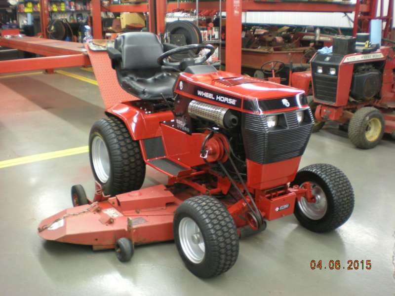

All we're waiting on now is the decal for the throttle + choke plate that's coming off this morning to be prepped. We have to put a knob on the front tach-a-matic, and the seat could be better, but overall it turned out pretty nice for a 2 day job.
