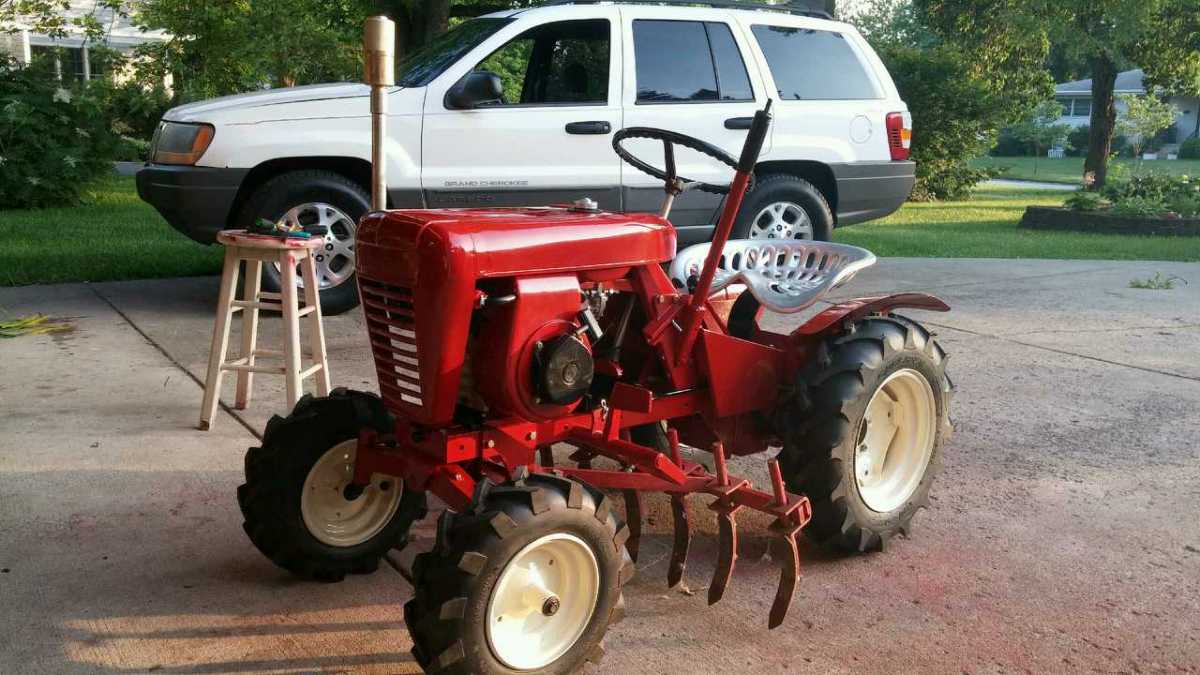

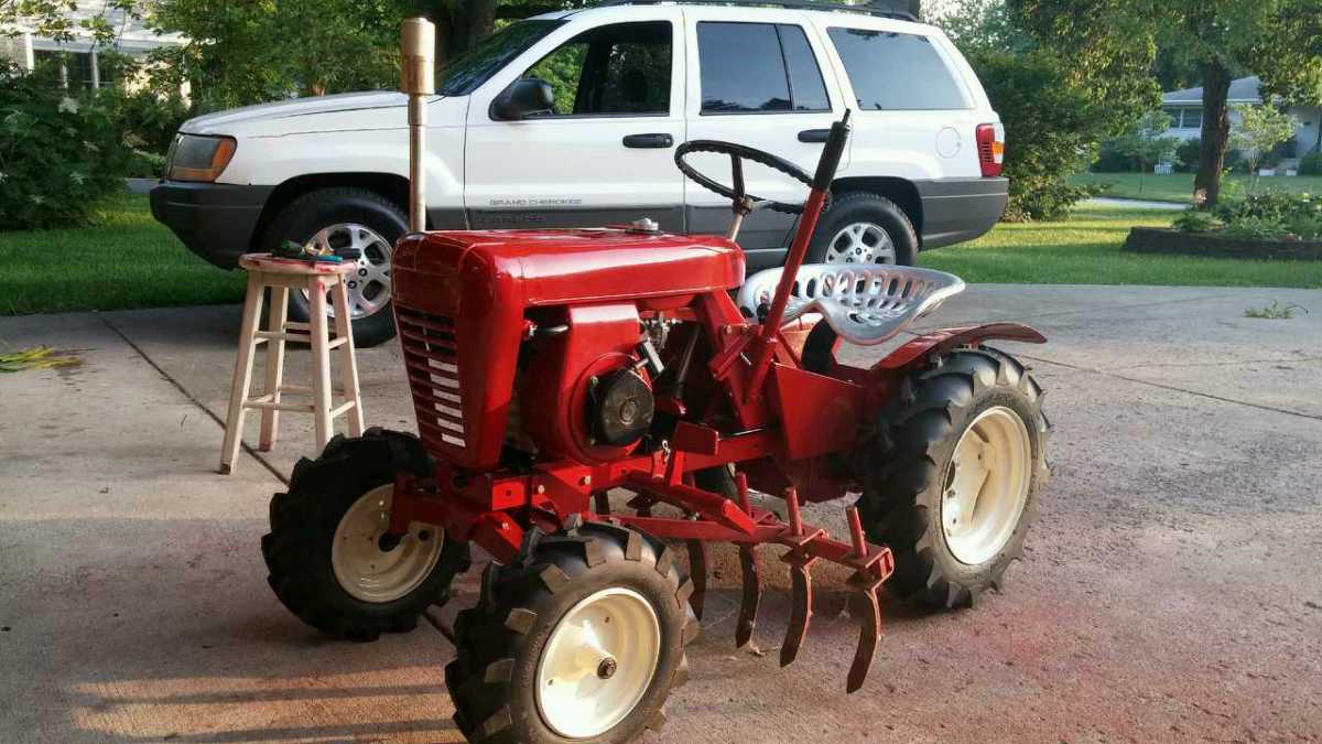

thanks guys for all your comments it seems like we are getting to the fun part
to me the sanding foam gives me a much more even contact area.
it takes away the pressure points that i would see when using colth.
it also produces a very nice feathered edge all by its self with normal use.
i use 2 like different types i will post pic after today of them.
the bushing is something i could not happier about. the steering feels great !
its a 3/4id X 7/8od flanged bushing just over $2 funny thing is the lock collar was just a few cents cheaper...
let me know if you cant find any i would be happy to mail it to you.
GT the engine a H70 has been gone through sitting next on bench waiting to have magenito put back on and set up.
ANY AND ALL HELP WITH H70 MAGENITO & POINTS w/ 3AMP COIL PACK WELCOME TUESDAY EVENING IN FRONT GARAGE.
STUDYING THE WIRING DIAGRAMS TODAY>
A RUNNER TUESDAY EVENING WOULD BE CONSIDERED A GOD SEND
Major not even thing is what it appears to be that perty seat is 100% cast aluminum and wieghts just a few pounds
hard to tell from pics but its unpainted and just its cast aluminum finish it came from a amish farm supply store a little east of me.

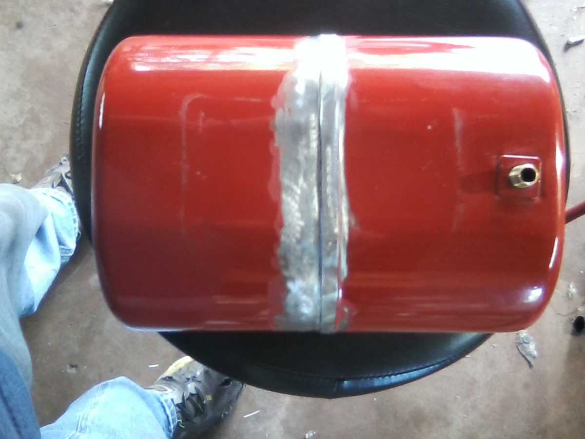

09 Jul 2015 22:36 #6661
when you smell gas, after the test run its not a good thing. the fact that the rustoleum is not effected by gas is very reassuring good thing! wiped off with no damage,
anyway added to the title today tin-smithing turns out the tank was leaking at the seam so i took it down to bare metal, added some good flux and some 95/5 silver solder.
no more leak, here a pic before the soldering.

09 Jul 2015 22:46 #6662
by JERSEYHAWG
Replied by JERSEYHAWG on topic 654 full restoration
Good thing you caught it. Good job. There is allways something,,,,,,,,,,,,,,,,,,,,,

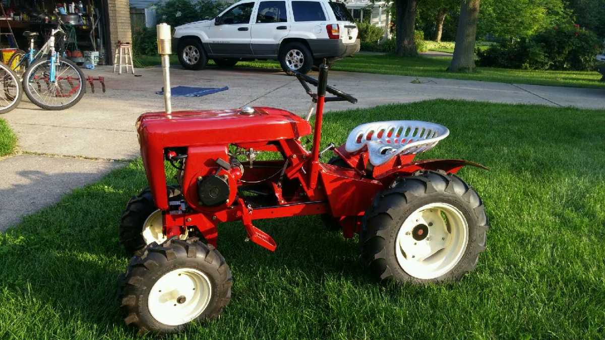

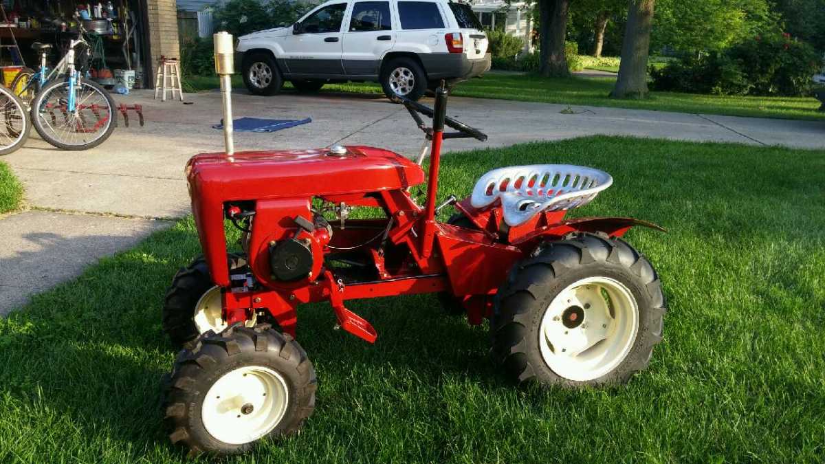

09 Jul 2015 22:55 #6663
well the tank is back in with no leaks...its made test runs good to go needs a little more of its bling. but it running like a top idle to full throttle. the governor pushing and pulling it to set speed.
its 3 amp coil is putting out voltage but no battery in place yet, and decals to be picked out more in the morning when i got time
