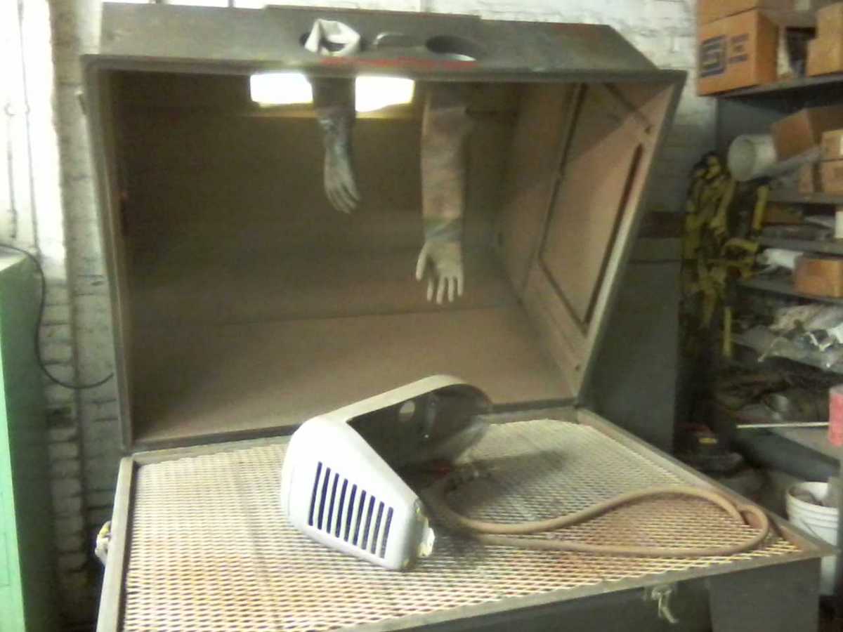

I call my the beast at times, like when its loaded up and your arms are in it for a hour at a time
you buddy passed up the beast and done got the whale that ate joanah
what are you using for air source ? do you have any type of air dryer?
i was always thinking of putting a incline screw conveyor out the bottom to help with clean out.
but i just keep using a old shop vac that i hijacked for the job.

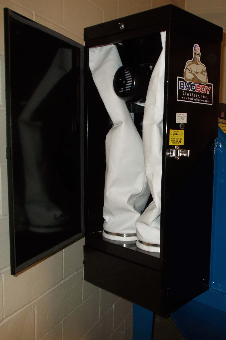

I have a Devilbiss 80 gal commercial unit. The video on their site is showing removing powder coat as fast as you can go at 80psi. I'm using more pressure than that now and the compressor doesn't run much so this new one should be an even easier load. The unit comes with 2 regulators + 2 dryers, one at each station. There are 4 blasting guns (all foot controlled, 2 guns + 2 stationary that hang from the top) along with 2 regular air guns for blowing things off (1 at each station).
The new one has an industrial vac, makes the same noise as a hair dryer. It has 2 vertical bags that you just shake out then open the drawer under it to empty and that's it. I have them putting the vac on the back of this one along with a wheel kit so we can move it around.

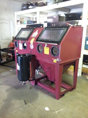

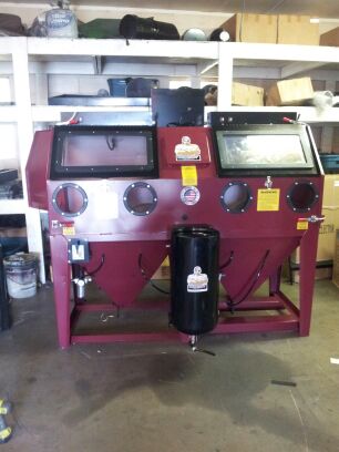

I talked to the girl that answers the phone this afternoon and she went out and took a few pics of it. Seems they have it almost done, I hope they got the color right... They're small but they are pics.
19 Jun 2015 20:11 #5991
Good grief! You could put a Volkswagen in that thing!:cool
Replied by M Bailey on topic The new blaster is in production
Geno wrote: I talked to the girl that answers the phone this afternoon and she went out and took a few pics of it. Seems they have it almost done, I hope they got the color right... They're small but they are pics.
