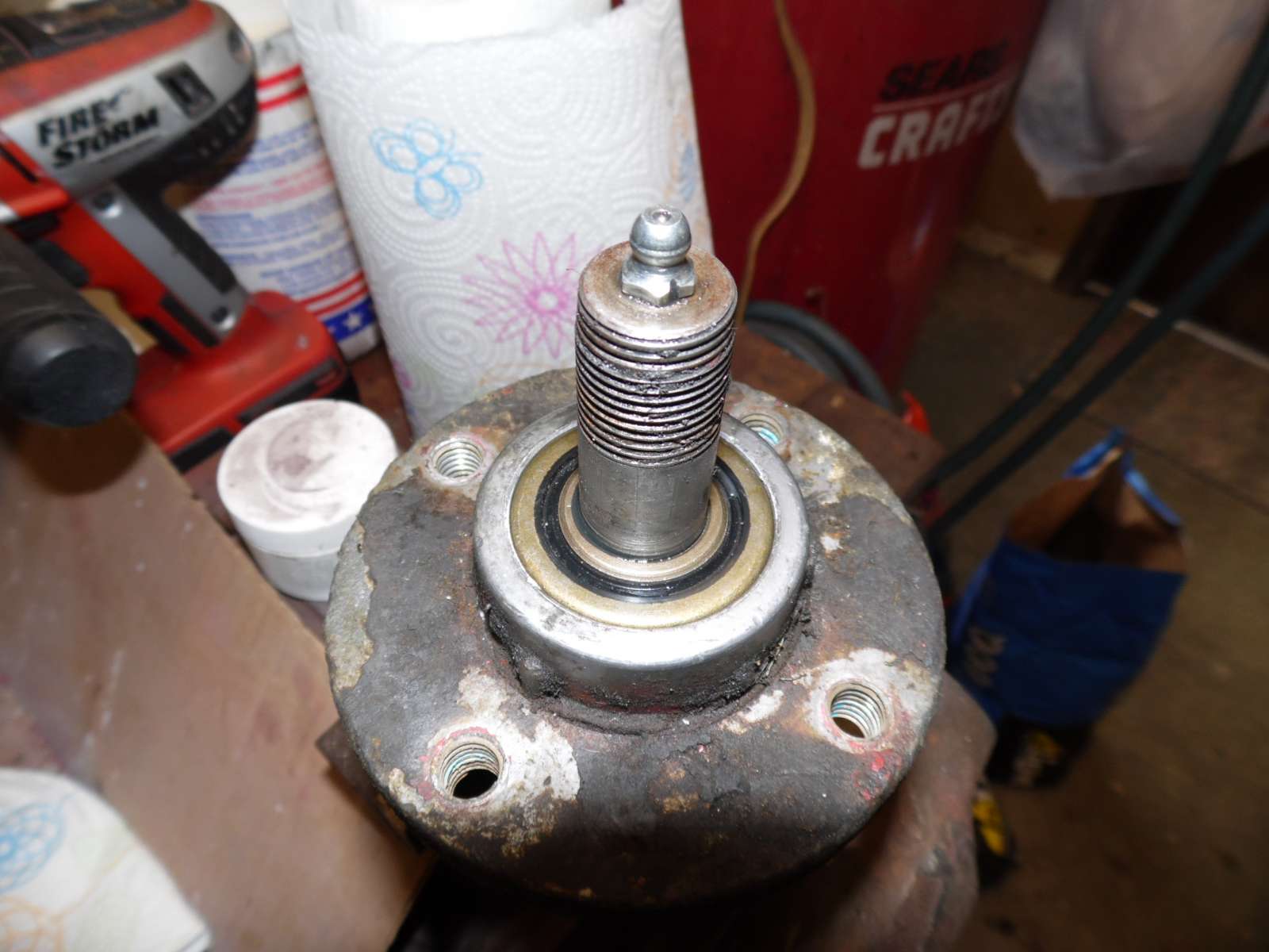

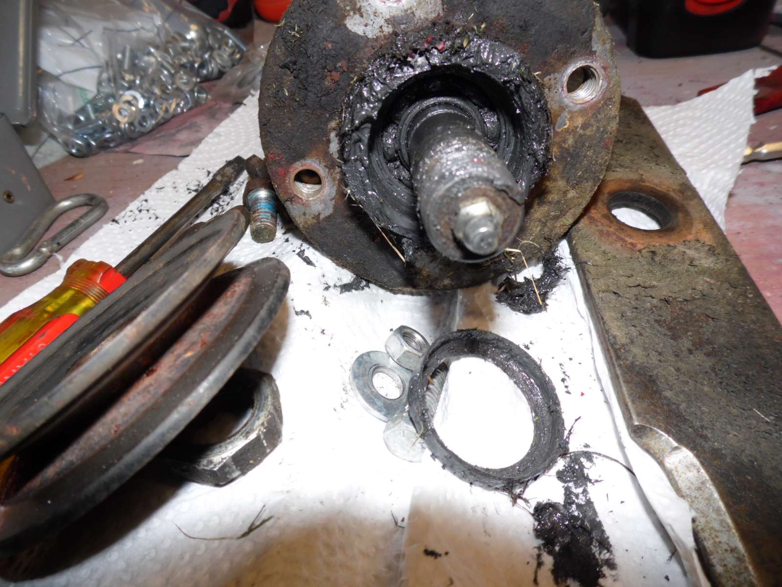

I wish I'd done this for the dis-assembly but you'll be able to see from the pics what to do to get one apart. This spindle is off of a 1980 model 05-42XR01 deck. Here's the spindle after the top spacer-seal shattered

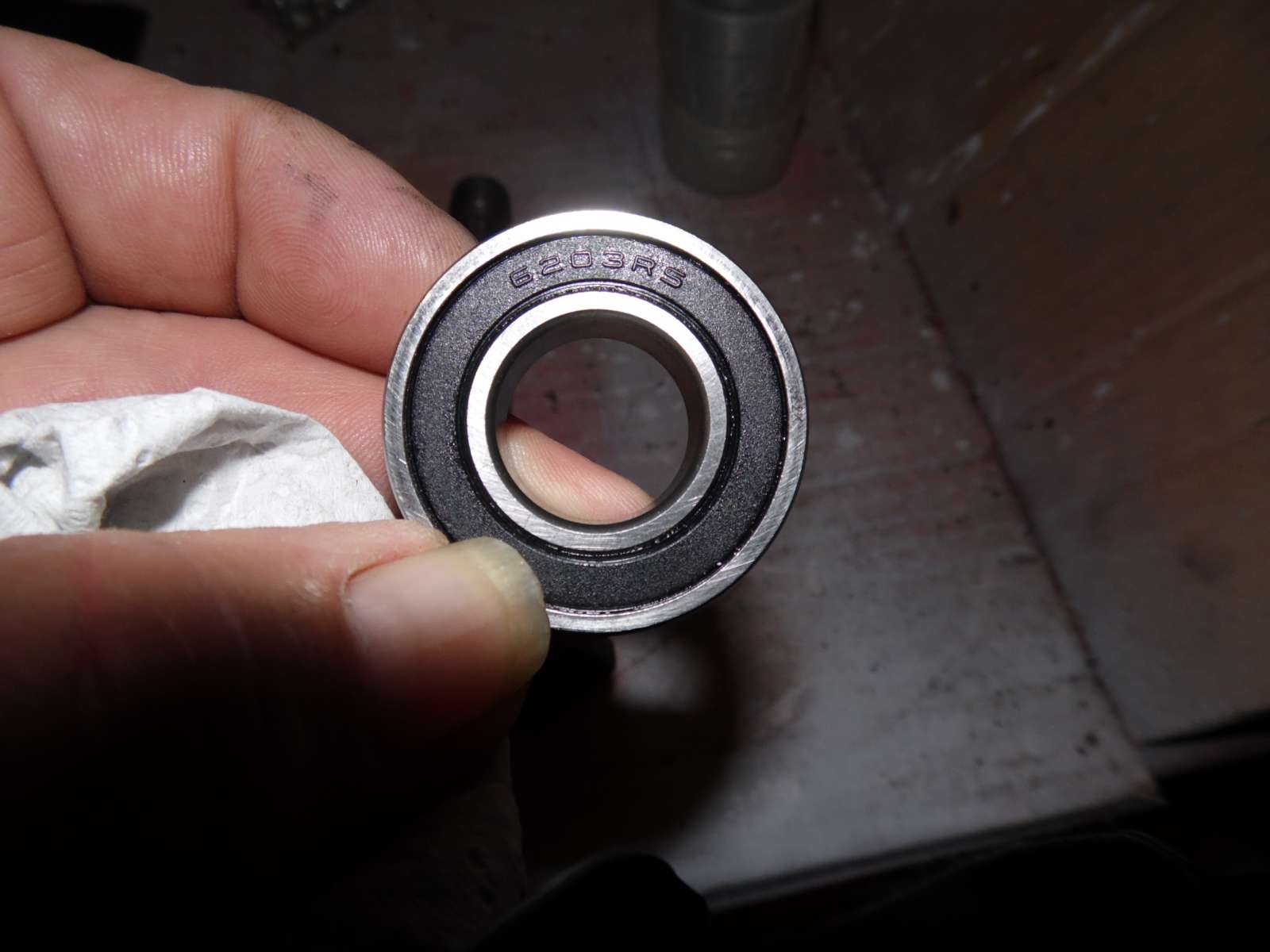

The new double sealed bearings: Toro Wheel Horse 106085 less than $20 shipped for a set of 6

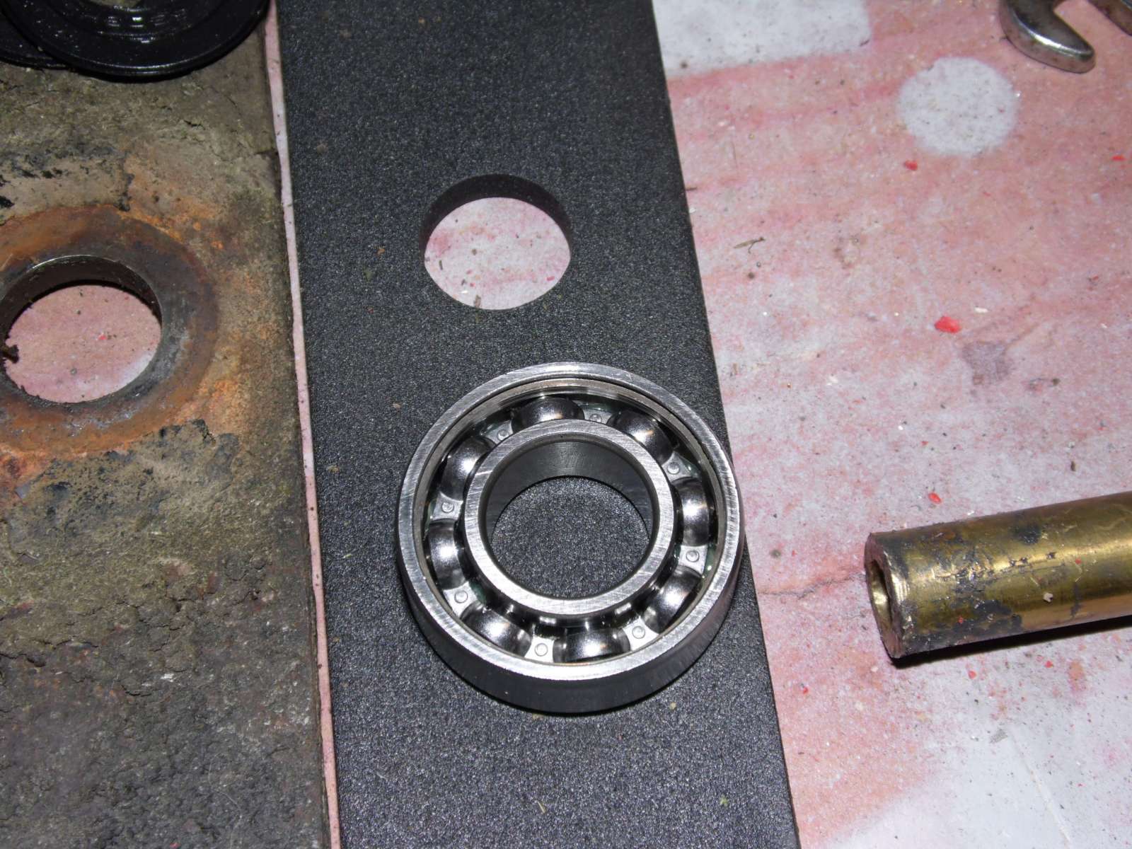

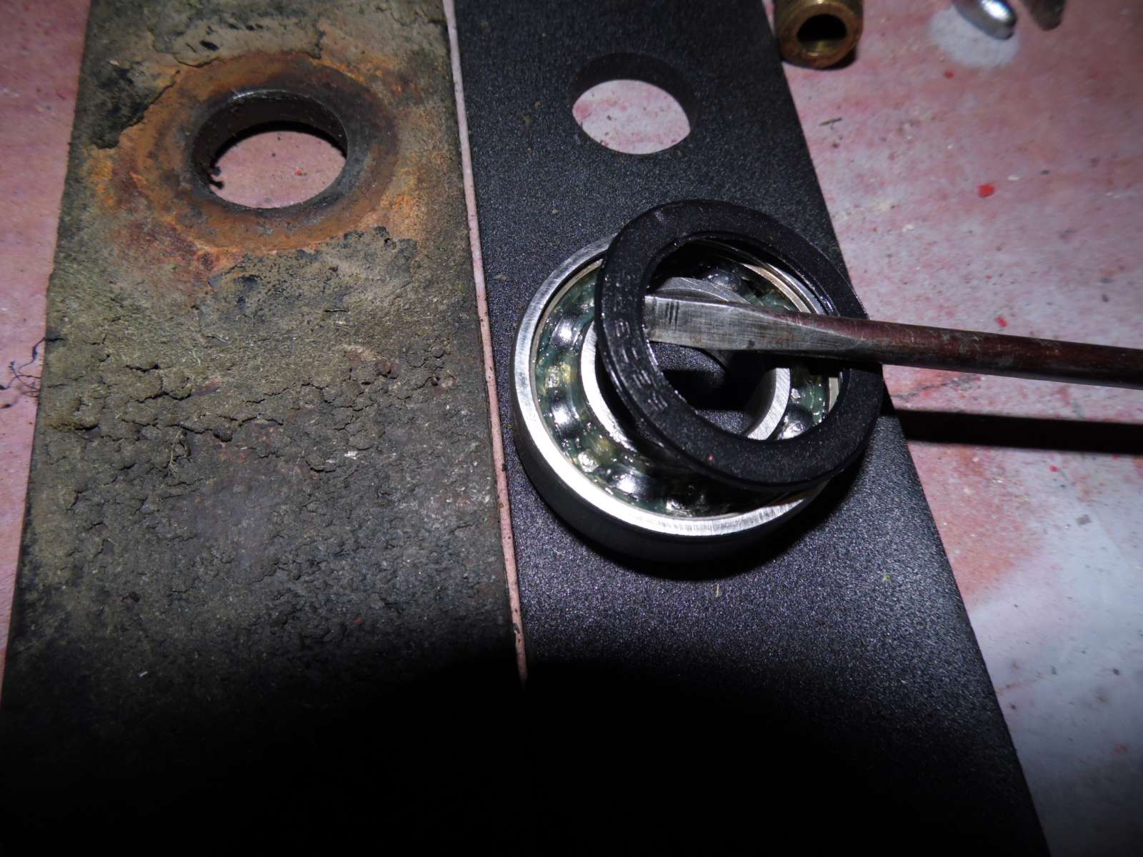

Grease has to pass through the top bearing and travel down into the top of the lower bearing so 3 of the 4 seals have to be pried off

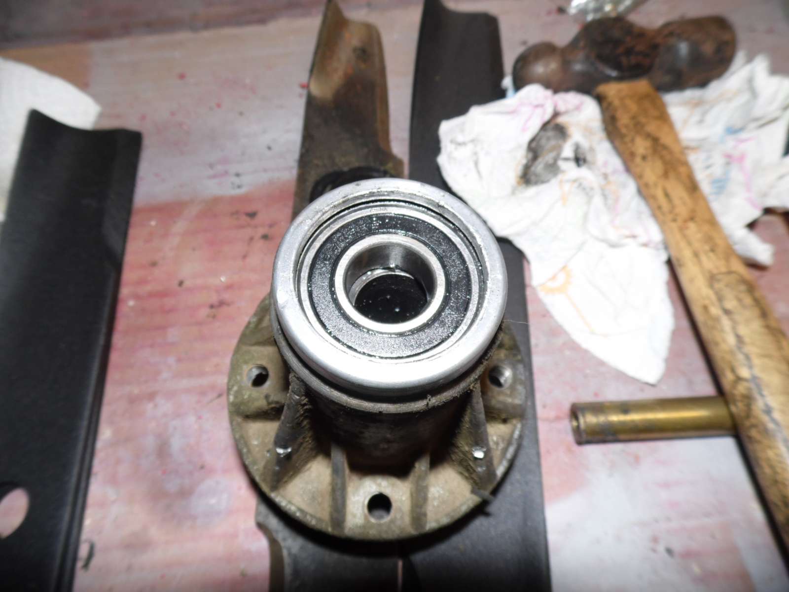

Once the seals are removed press the bearing with no seals into the top of the spindle housing

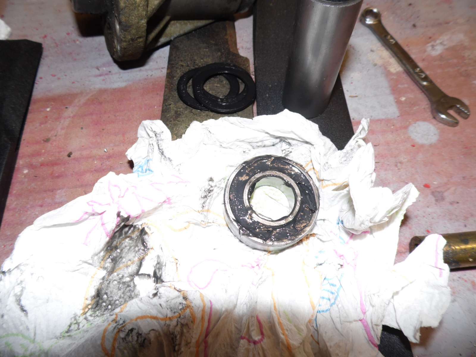

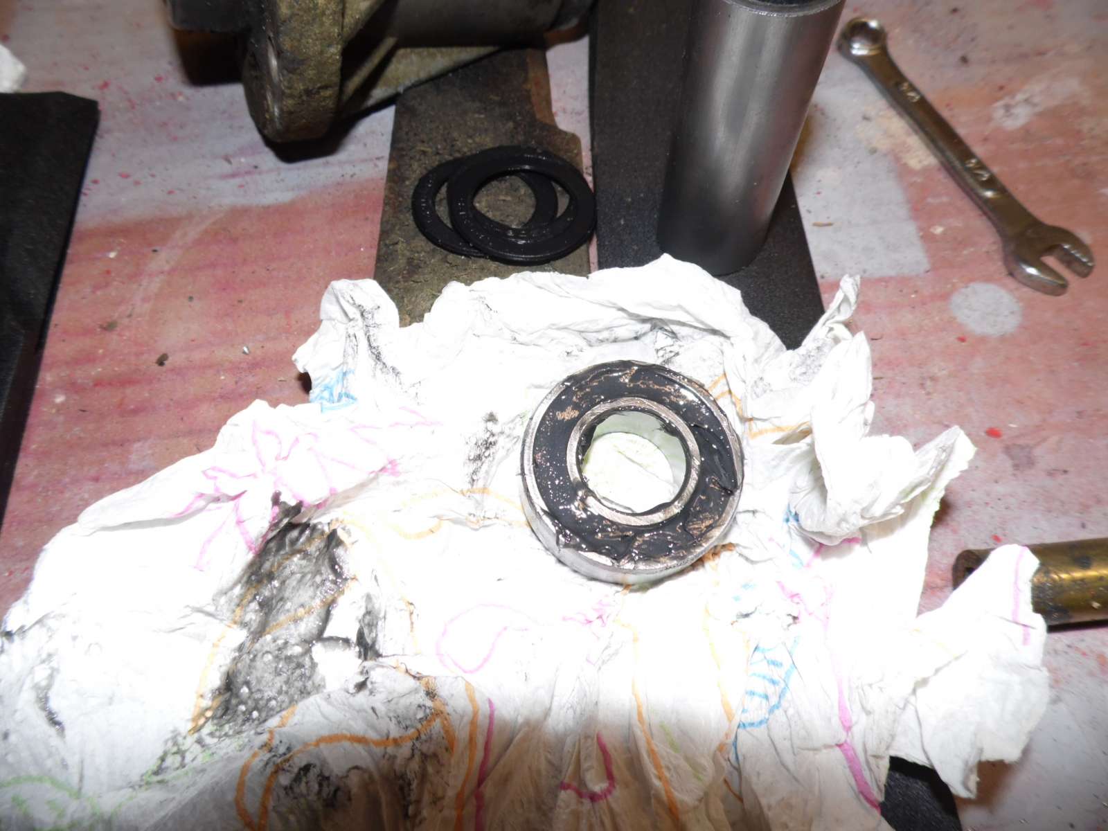

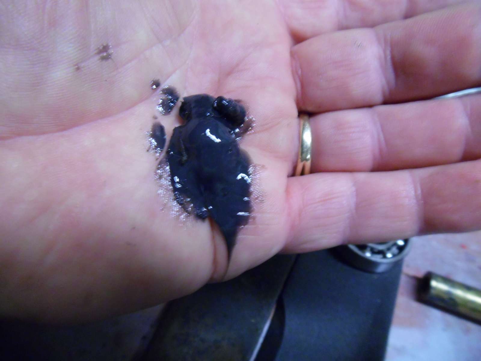

In case you don't want to remove the seals on the bearings and run them sealed, here's what one of the bearings looked like, notice the absence of grease. This is the bearing with one seal in place which goes on the bottom of the housing.
We'll grease this one "old school"

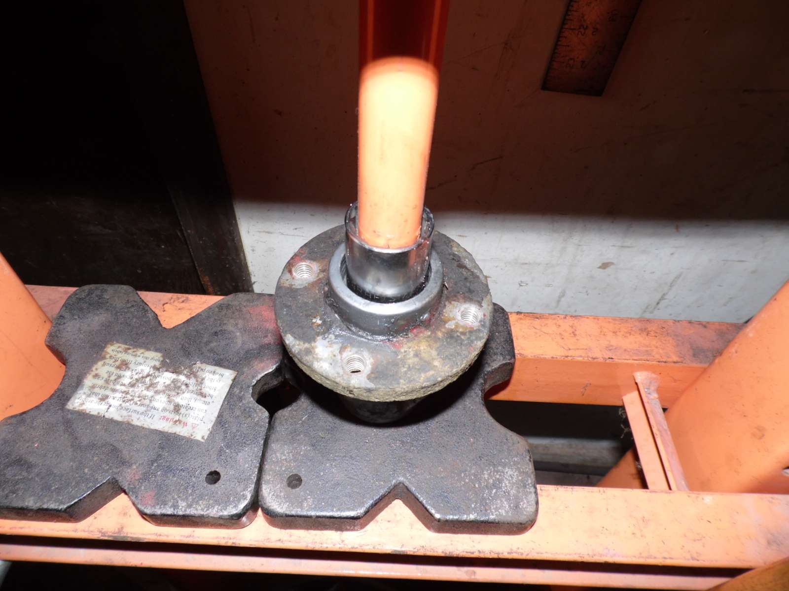

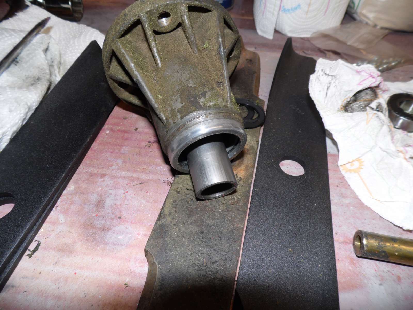

Put the long spacer in the housing and press in the lower bearing with the seal on the outboard side as shown below

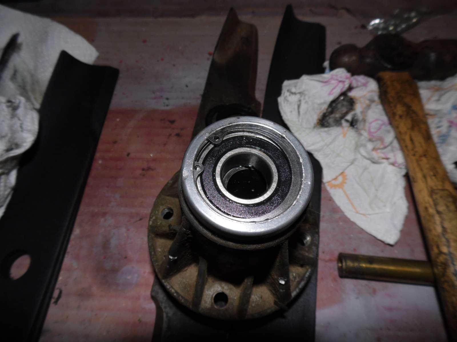

Install the snap ring

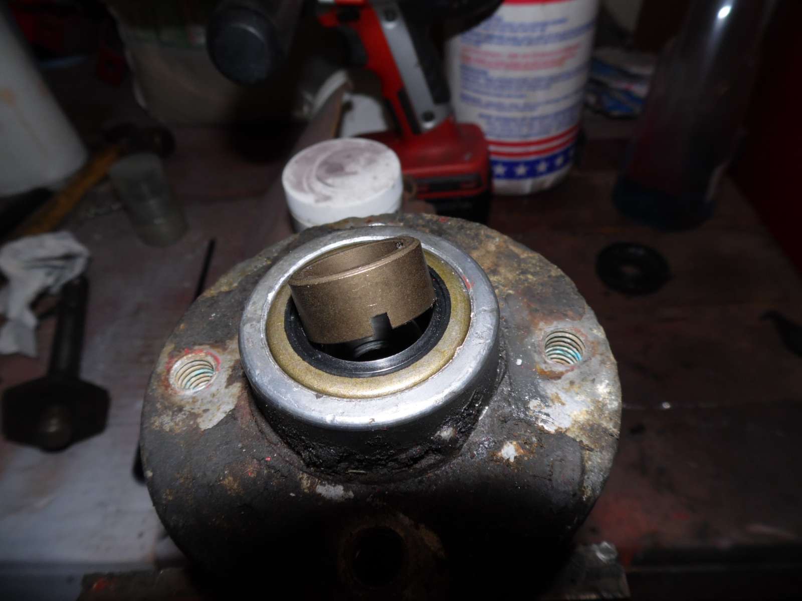

Install the top grease seal followed by the spacer-seal

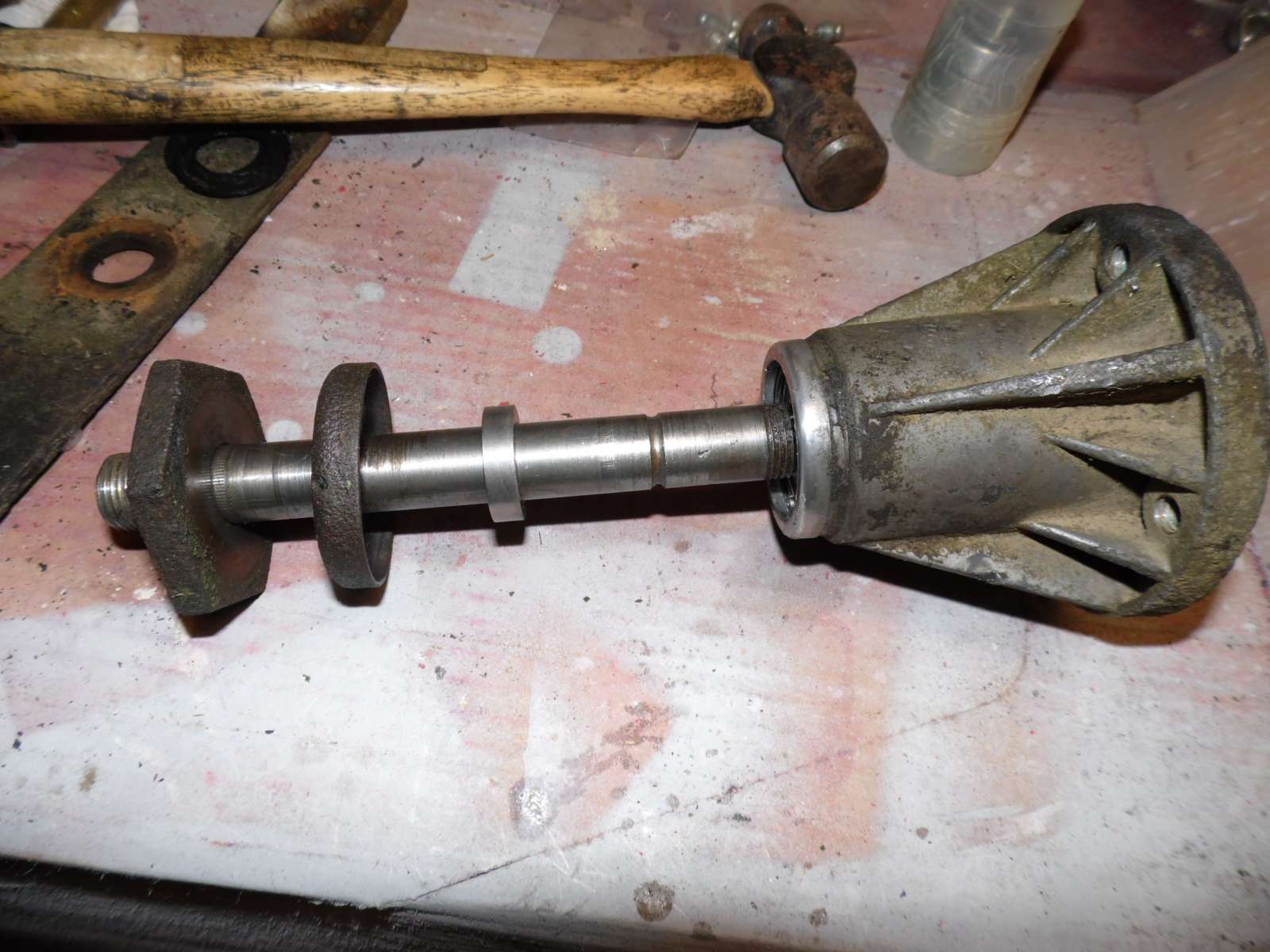

Next install the spindle shaft, spacer and cup as shown
