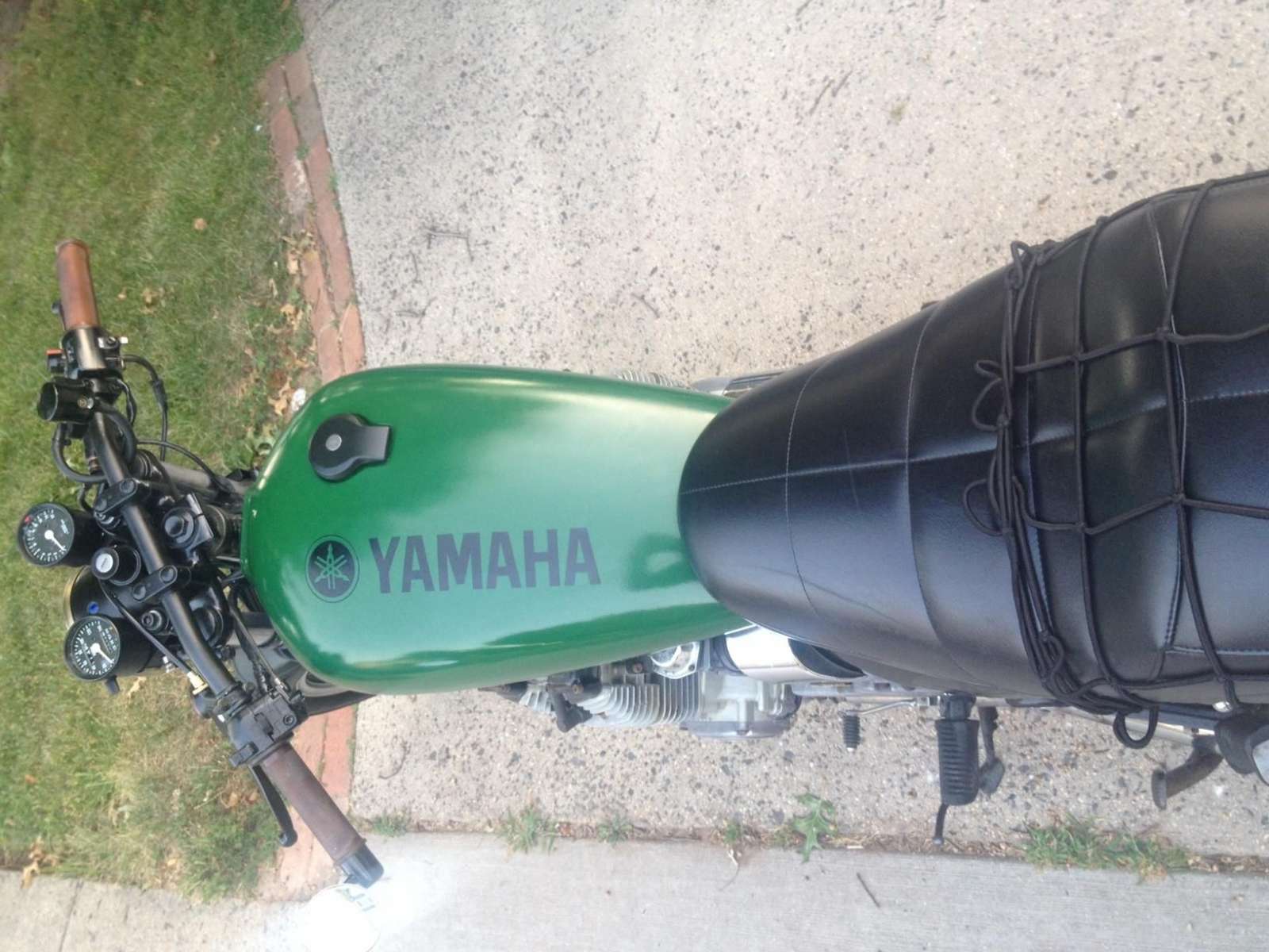

25 May 2015 06:14 - 25 May 2015 06:20 #4871
Replied by Trouty56 on topic Clearcoat application
I keep reading about this stuff....guys use it a lot in the bike forums to coat gas tanks.....and use it over all types of paints.....Rustoleum, Valspar, Duplicolor....say wait a week....use precautions though like a full mask and paper suit.....this stuff can harden in the lungs....get into skin/eyes.......fuel protective coating is why they use it for tanks.....
This is over rustoleum......can't get the image to tag.....arggghhhh.......OK....I'll upload it then.....

25 May 2015 08:06 #4875
Replied by Geno on topic Clearcoat application
You never know, technology is changing every day with this stuff. Longer term results will tell if it will actually last.
