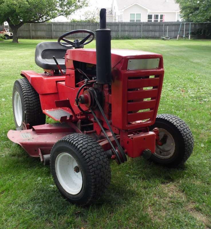

Nappypappy, I used a piece of aluminum angle and a u-bolt for the lower clamp that is attached to the bracket.nappypappy wrote:
Very nice and is that a u clamp?motor12 wrote: My 854 with stack and a shot of the support bracket.
Also I like the way that fuel line is run.... :goodjob

Nice Tractors.....Nice stacks.....

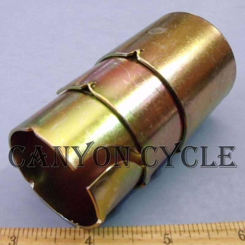

My biggest problem is attaching to a 1 1/4 in pipe.....that is the OD of the pipe used on the engines.....
I have bought the AC1 mufflers from TSC for about 20 bucks (NAPA sells them also under their own part #) with a 1 3/8 inlet and a 1 1/2 outlet..... Where I attached the muffler to the pipe is always my sore spot....looks like heck.....

Nice.....new products I never knew existed.....thanks major.....M Bailey wrote: These exhaust reducer bushings are life savers and save a lot of :angry2
