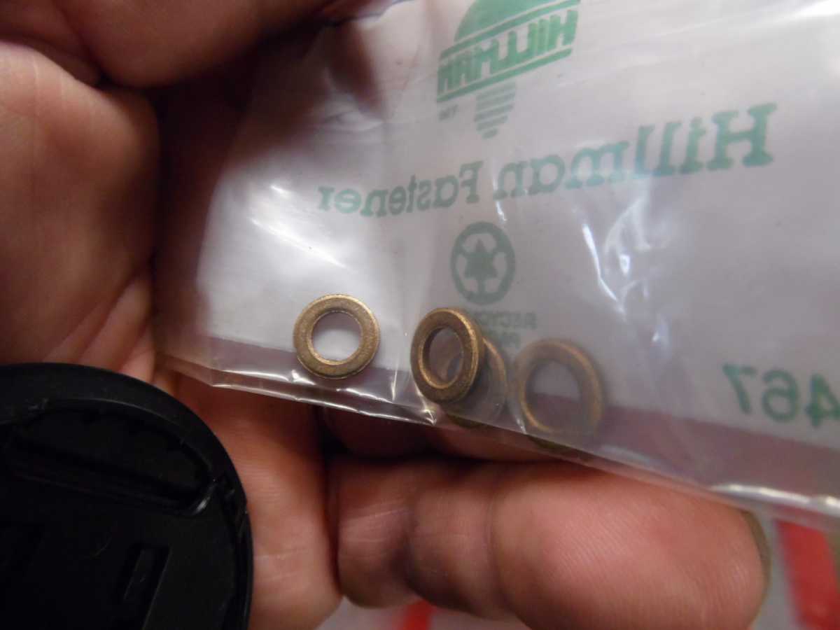

Be pulling a few carbs for rebuilds this year and if the throttle shaft is loose am going to try this.....
Info from the video...."THE THRUST BEARING IS 1/4 X 7/16 X 1/16 THICK BRONZE AND THE SCREWS ARE 3-48 X 1/4 BRASS,"
Guess he used a drill press for convenience to set the bronze thrust bearing.....quick and easy.....little loctite....

03 Jul 2015 09:12 - 03 Jul 2015 09:45 #6475
Great tip Bob and it really works well. Done a couple of them using 2 Hillman 58087-A 1/4 x 7/16 x 1/16 bronze thrust bearings stacked in the recess. A single would probably work okay but @ $.80 ea from Ace Hardware doubling them up seemed like a good idea.
Replied by M Bailey on topic Throttle shaft bushing fix
Geno wrote: I think Major has done this on a carb, someone around here has.
