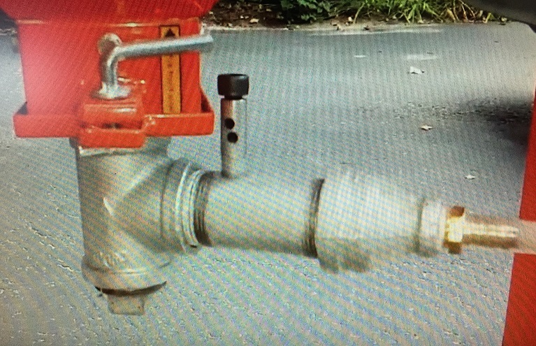

On another note it really helped getting my cheap HF sandblaster working right. Added a metering system under it to replace the crummy siphon system. Changed the exhaust around so I could see what was going on and put new lights in.

So did you turn it into a pressure blasting system? Do you have a pic of what you did inside? :smile2
09 Nov 2020 16:57 #16463 by GT 14
It is not a pressure system.
Still uses suction but with gravity feed.
Works 1000% better than a suction tube in the sand. Had to run the hose through the front of the cabinet.
09 Nov 2020 19:34 #16464 by Geno
Ah, now I see what you did, nice setup. :10

GT 14 wrote: It is not a pressure system.
GT, I like what you did for the suction side. I might just steal that idea for my TP Tools blaster cabinet.
I have to do some work on my cabinet this spring. I wore out the trigger gun and I think I'll add a foot pedal and new gun. Good time to improve the suction.
Thanks
Thanks
This was not my design, got it from You Tube. Here is a link to it. There are also units ready made for this.
