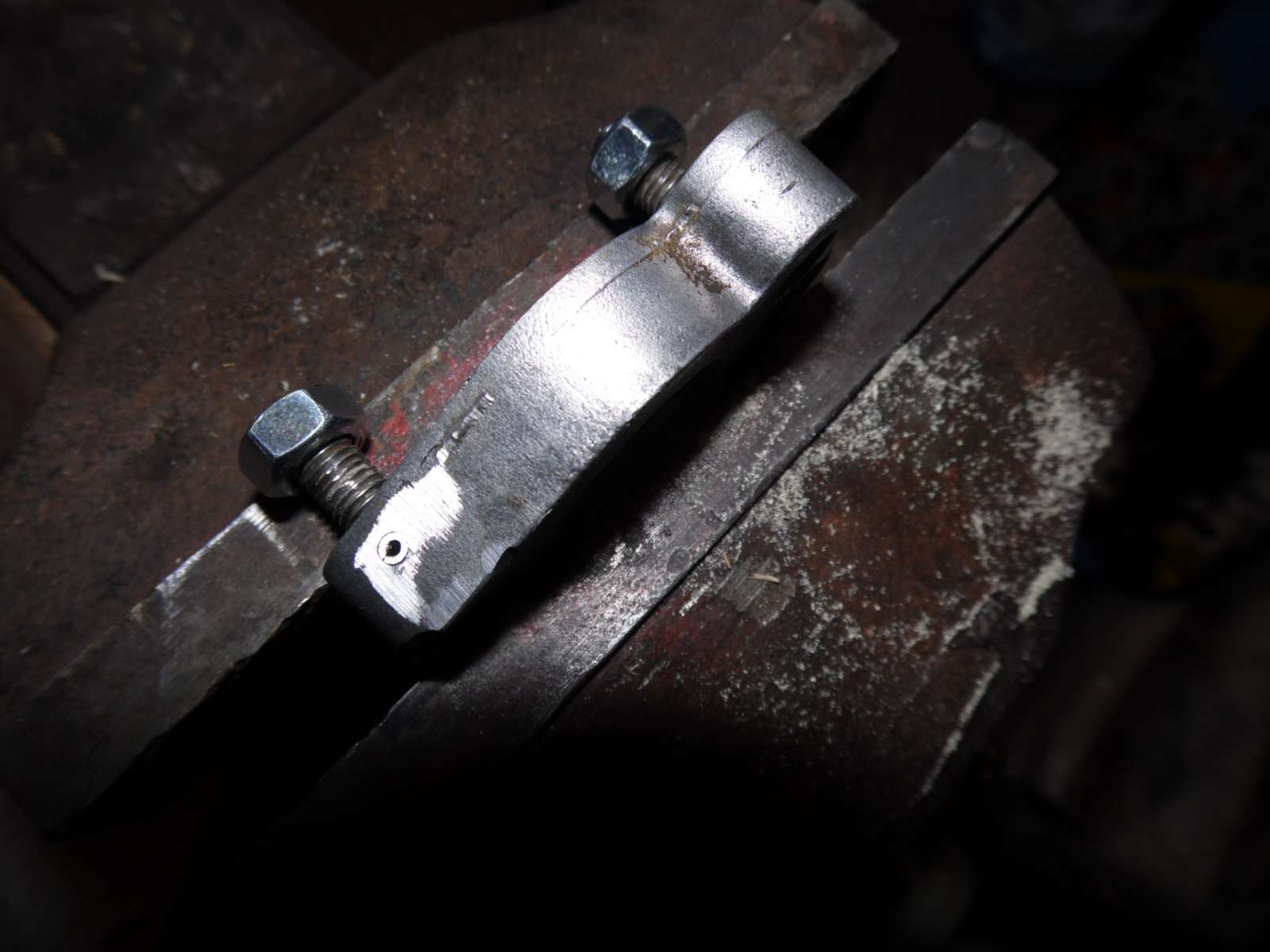

These H60 carb adapters can be a real pain when trying to remove the carburetor by itself. Why they designed these this way is still a mystery to me! The 1/4-28 bolts are free to turn when removing the carb so here's the fix.
Drill and pin the bolts as shown.

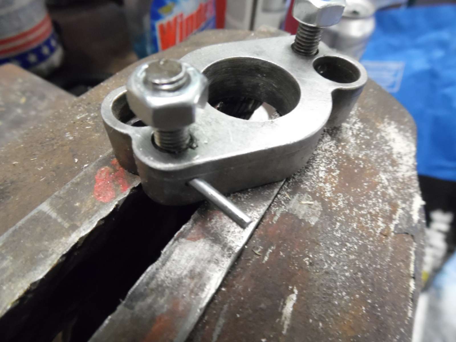

Cut off the excess roll pin

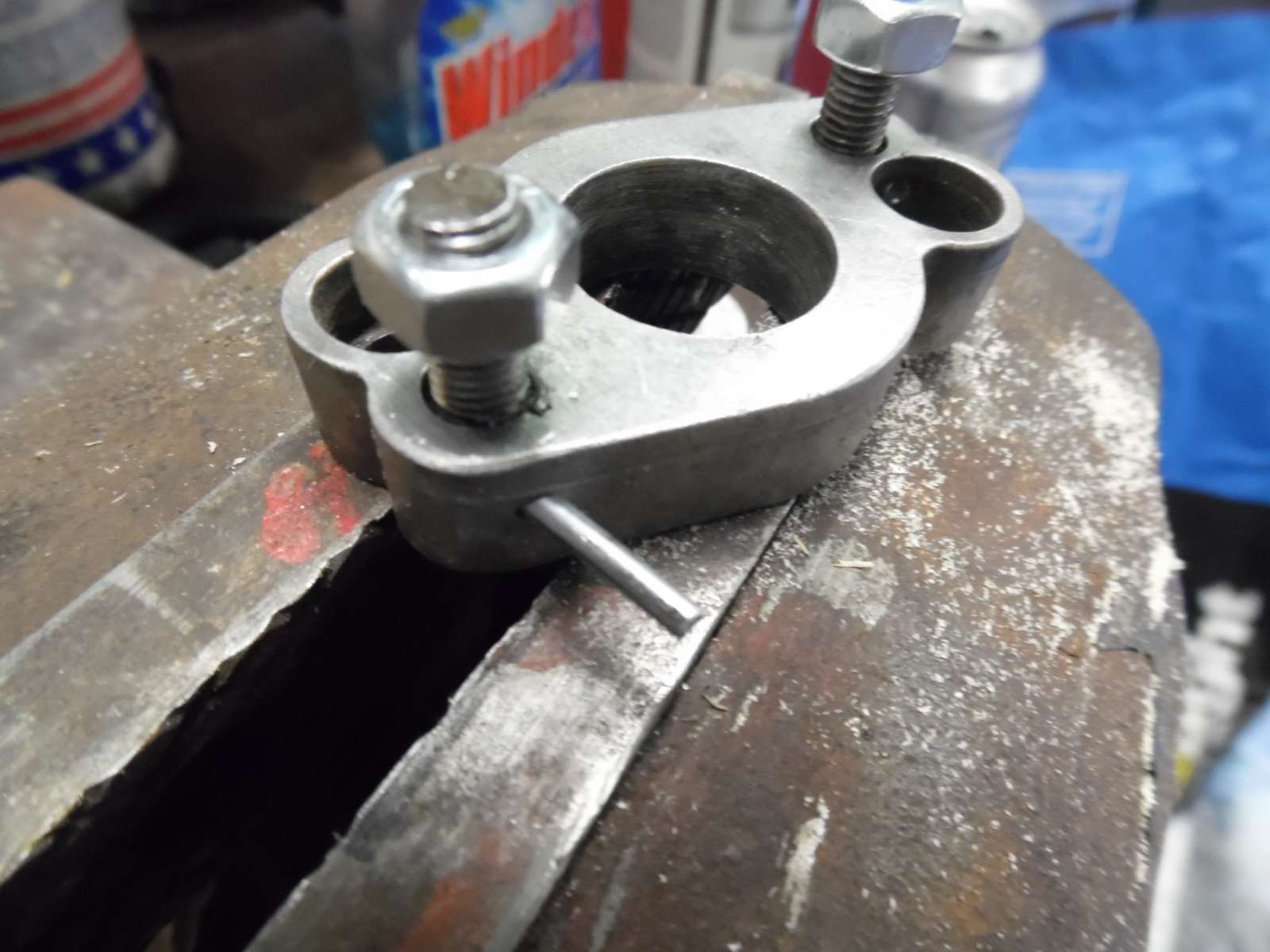

Grind level the roll pins and now we have 2 fixed studs on the carb adapter!

22 May 2015 16:45 #4792
Replied by M Bailey on topic Techy Carb Adapter Mod
Thanks Pappy, you would have thought they would have molded the studs into the adapter but sadly that was not the case.
