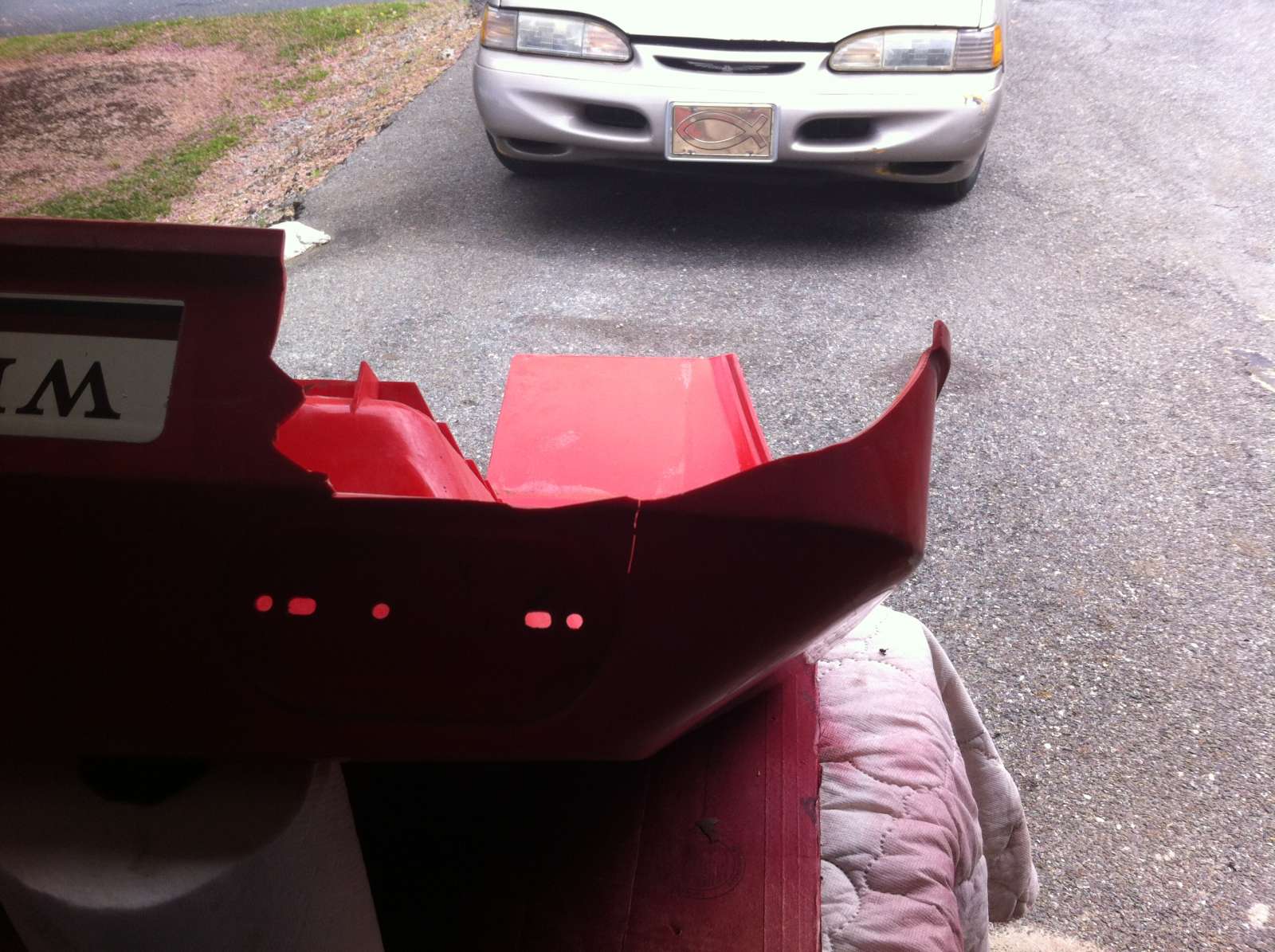

Plastic fender repair was created by GT 14

yup its broke....will be watching the repair... :smile2

Fiberglass tape and putty here we come!!!

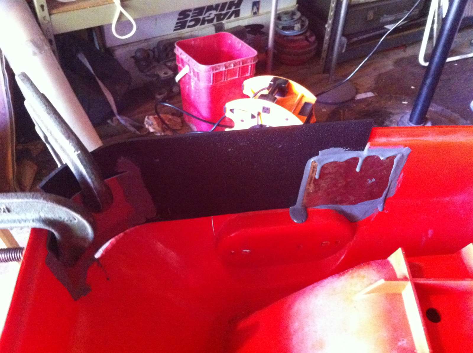

I have a sheet of 1/8 ABS and I am fabricating a patch. I think my trusty JB Weld will handle the job.

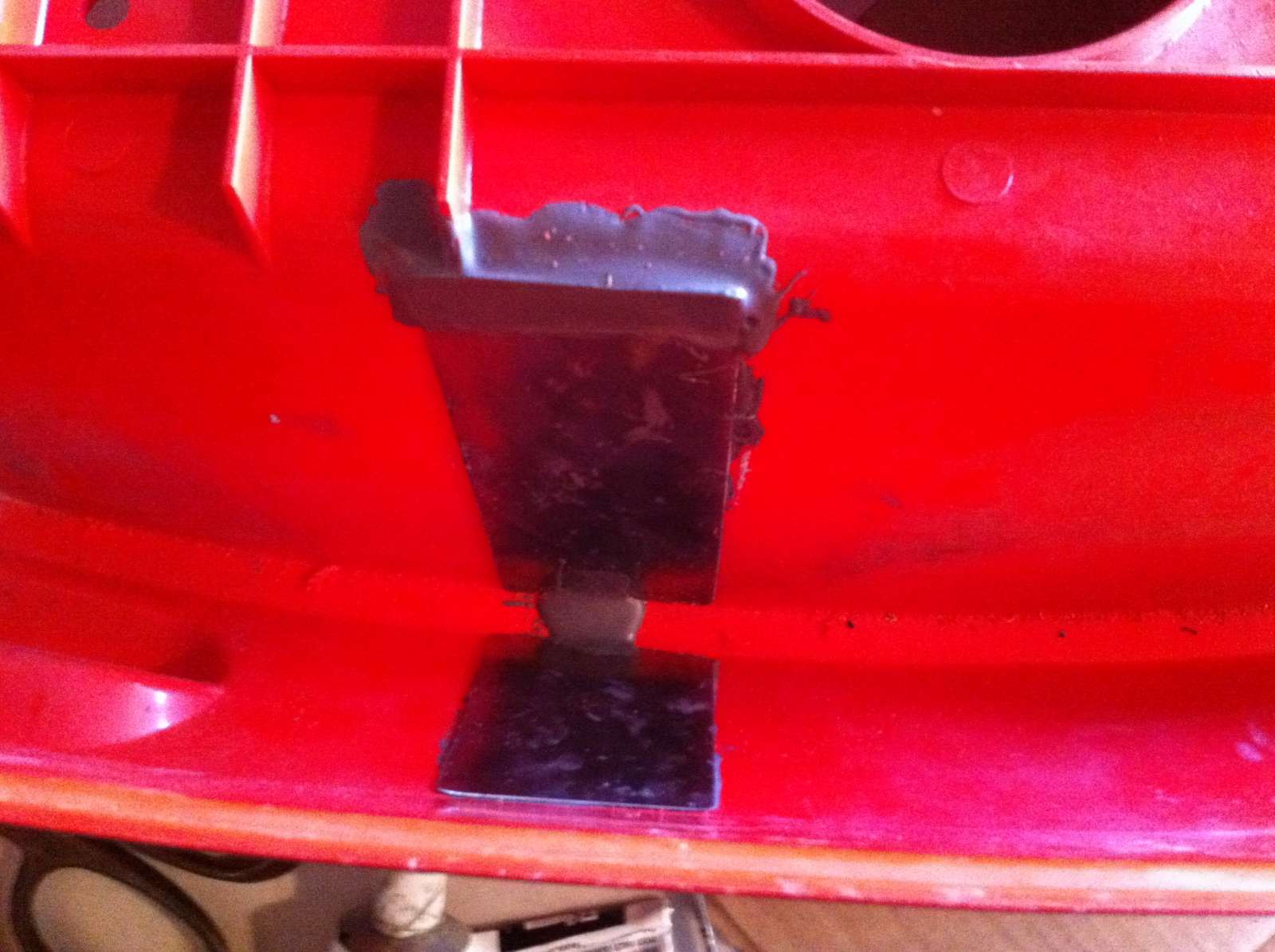

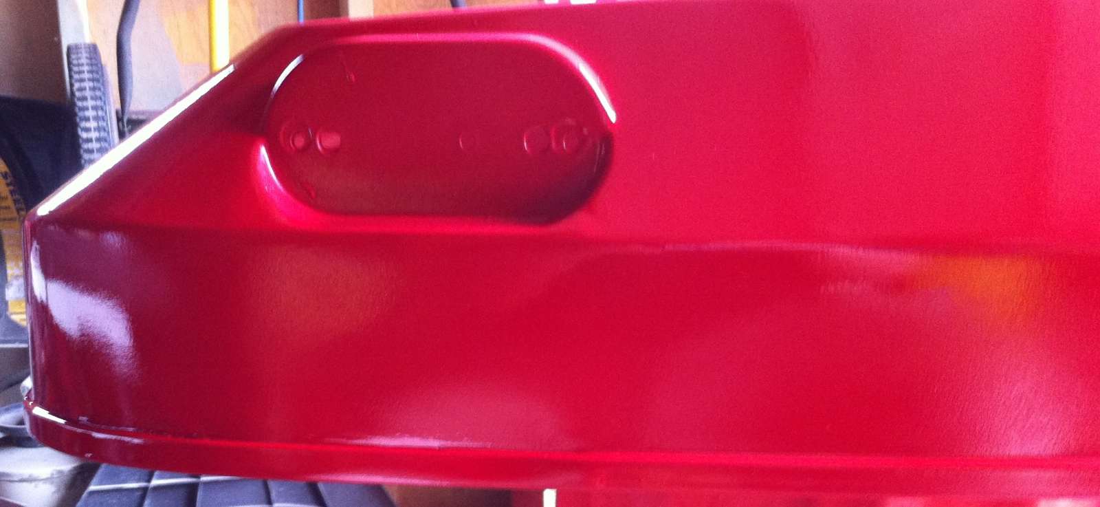

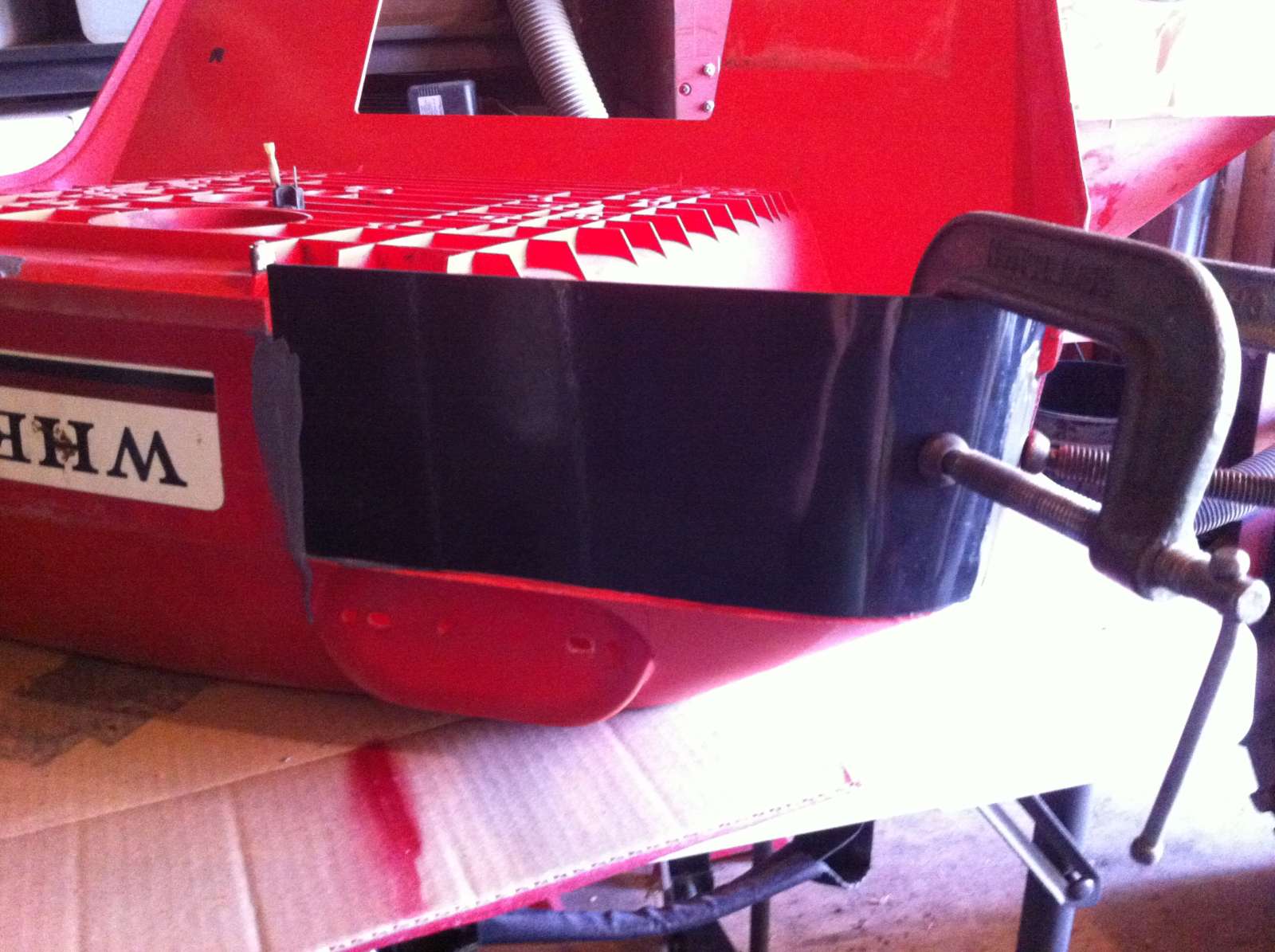

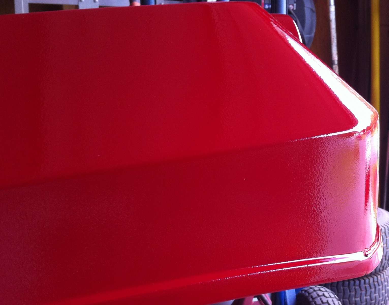

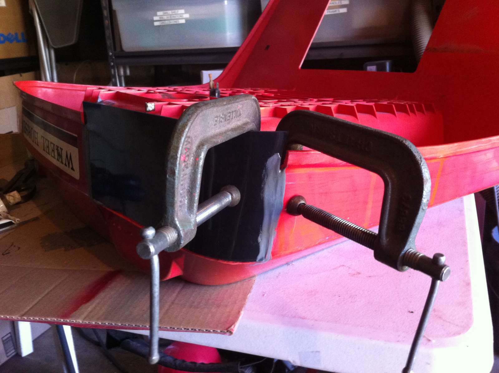

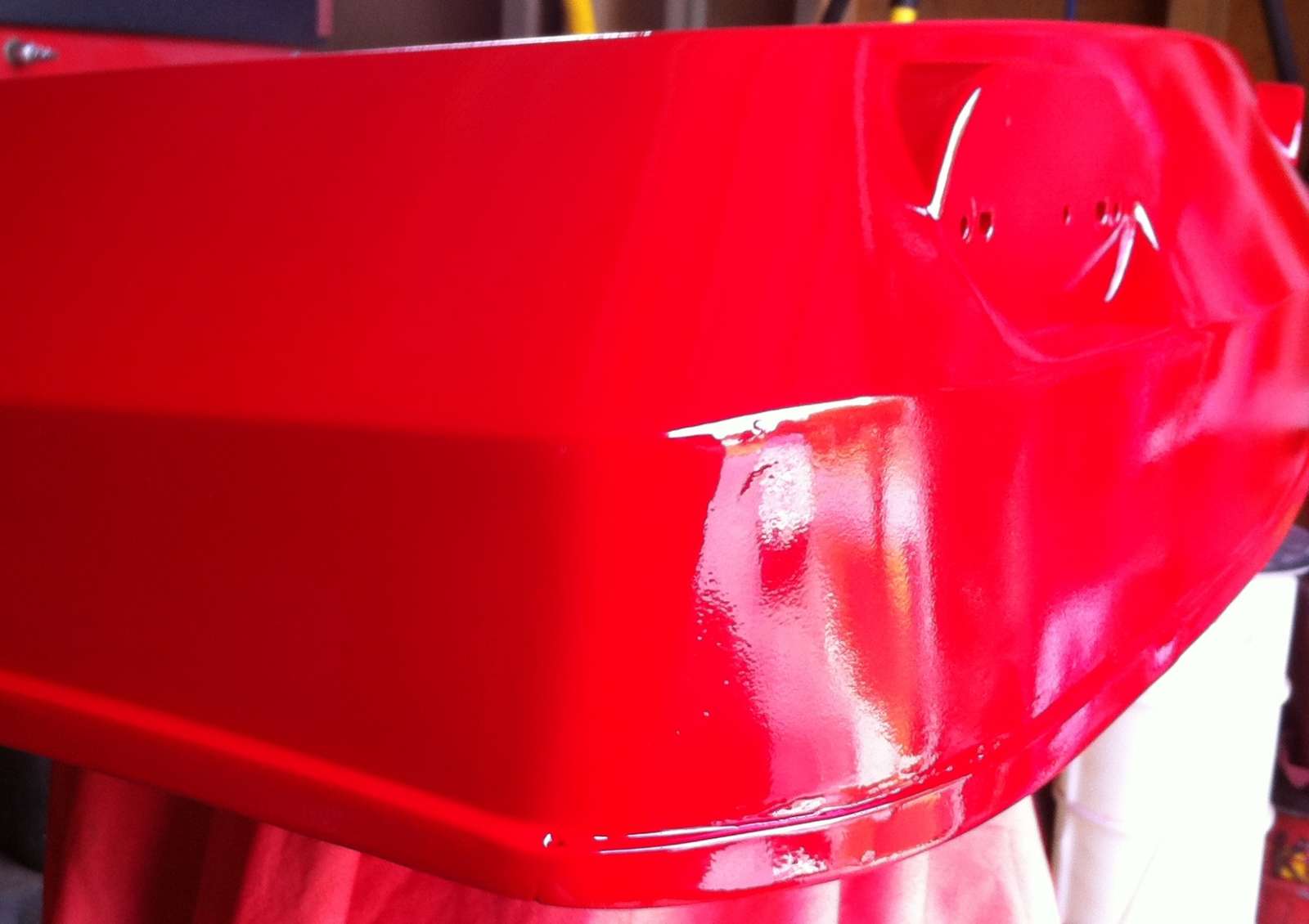

14 May 2015 19:54 - 26 May 2015 16:04 #4499
Replied by GT 14 on topic Plastic fender repair
Here we go
Squared up the area, and cut and shaped 1/8" ABS. Used heat gun to get the curve.
Decided that strength was needed so I am using small squares of sheet metal.
Covered the entire piece of metal with JB and clamped.
Also repaired a large crack down the middle with same process.
Finally the new fender has emerged!
Last edit: 26 May 2015 16:04 by GT 14.
